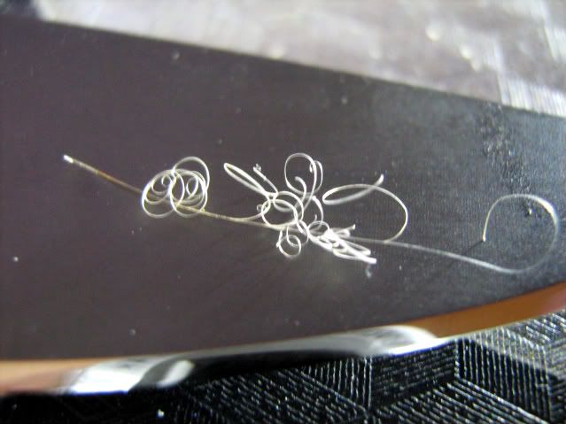

Hair whittling is a good test, a knife will shave hair at many different levels but to whittle the hair is much harder.
Hair shaving= good
Splitting hair 1-3 times= very sharp
Splitting hair 3-5 times= Stupid sharp
Splitting hair beyond 6 times= now your just having fun :D

I have statistic thread test - 21 cuts like this.
http://www.youtube.com/watch?v=1Ftbus7LbtU
But to have fast check - whittle hair:
http://www.youtube.com/watch?v=aQPwHu4lxsQ
