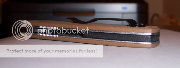

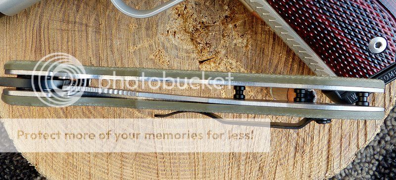

Now that I have had a few Emerson knives with the standoffs and have a few with the original back spacers, I dont see any performance or toughness differences.
Curious if anyone else has??

There are a couple advantages of the standoffs that I can see.
Less model specific parts to make and stock, and less labor making the individual spacers.
The screws go into the standoffs instead of the opposite liner so if you strip one you can just get another standoff instead of shipping the knife back to have the liner repaired or replaced if the threads in the liner get stripped out.
Plus as mentioned it may appeal to more buyers and it is easier to clean without disassembling.
