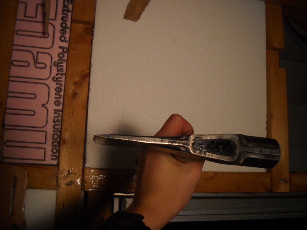

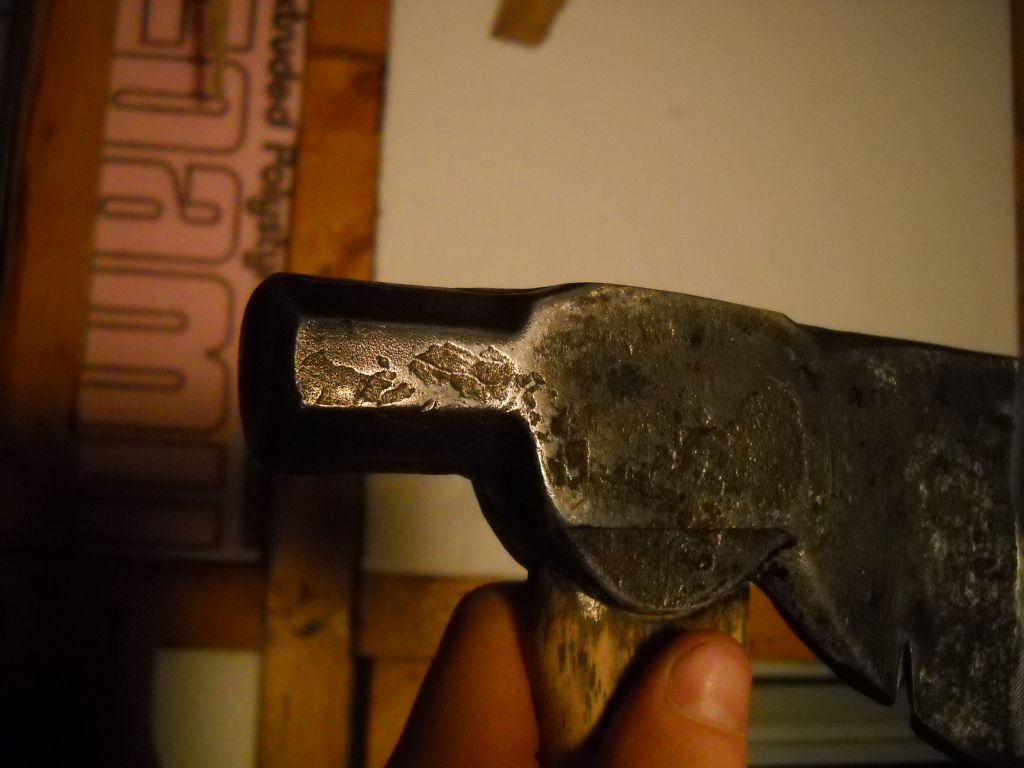

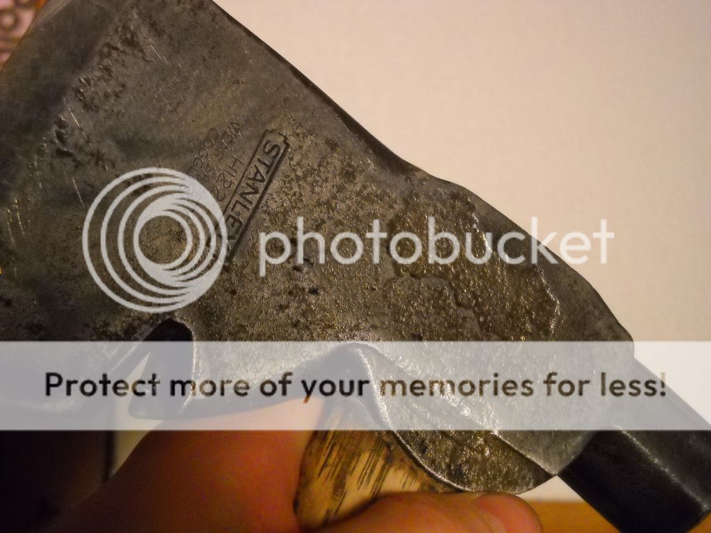

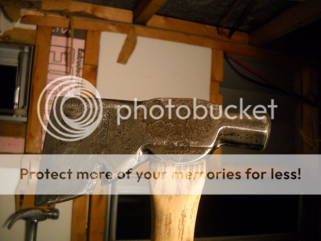

Here are some pics

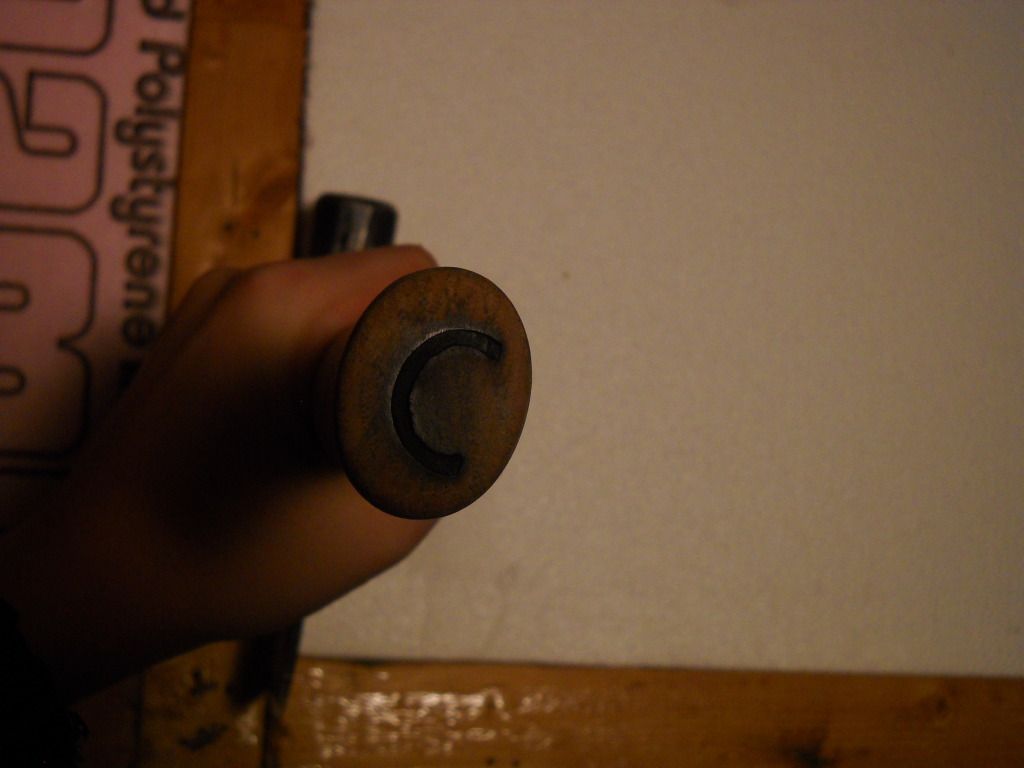

And my initial that I branded on the butt.
I haven't stained the handle yet, btw.
It looks great. I see what you mean about the micro bevel, it's visible in that top down photo. Doesn't look so bad that a file couldn't fix it. I bet it's hard steel, though, so you'll need a fresh file.
Thanks for the pics.

That's not the micro bevel that was on there, it's the one I put on, the pics make it look worse than it is it. The angle was about 60-65 degrees. Now I have a better bevel, that has file marks on the very uneven faces, no sort of polish, and really looks like crap; but it sort of works. I have never sharpened an axe or tommy before, so I hope this is as bad as it gets :o. The steel was a pain, and I had to unclog double cut bastard Arcade often.
