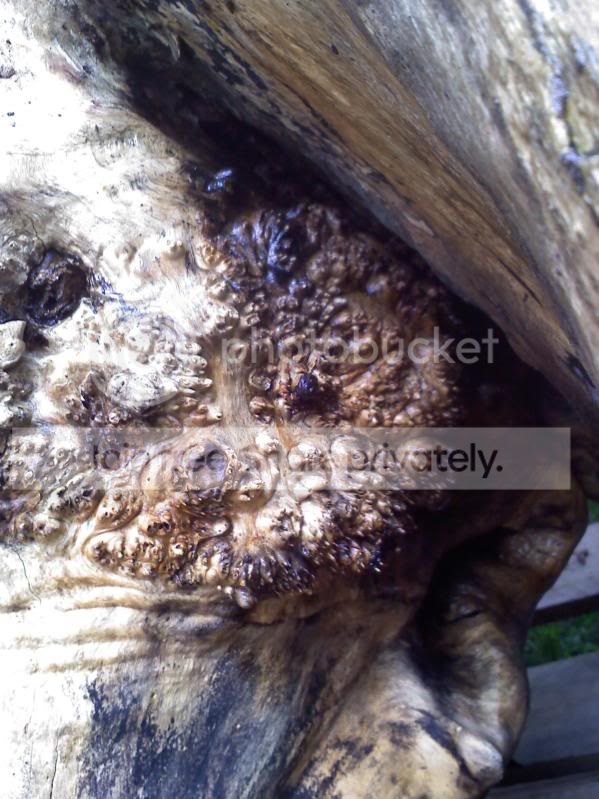

I have been out searching some friends properties, and have found some great wood to cut up. Here is a box elder root system...At the best price, Free!
Should hopefully get this to the sawmill later before heading to work. Hope to find some usable wood in it :)

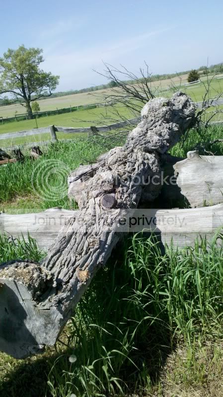

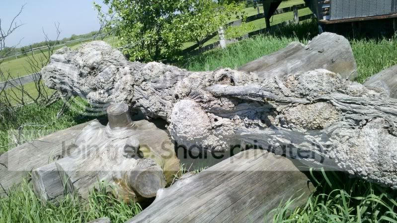

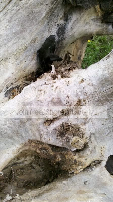

Thought i would post a few pics of my newest find. This is Honey locust, 16 feet long and LOADED! Still waiting on the sawmill to get the box elder done....
Should get a few decent handles out of this one :)
Mike, that looks like it will be nice! Is each "ball" a burl?

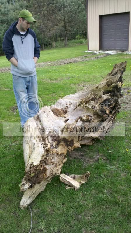

Wow!!! That's freak'n cool. :) I'm real familiar with spotting burls here around the Northwest, but I'm curious about the Box Elder.... is there any indication of it having the red spalting colors in it while still in the rough.... or do you only know once you cut it open???
Mike at WSSI sold me a few blocks of the red about 11 or 12 years ago and he said he nearly had to give it away....nobody wanted it. Fast forward a few years and he could never get it or keep it once he did because people changed their minds and like it now. I love the stuff myself! Even the clear box elder burl is beautiful... the light color goes really well with a damascus blade and heat-blued fittings!!! :)
No way to tell from the outside...At least not from what i have found. From what i was told yesterday, and this sounds crazy, the female trees produce more heartwood than a male tree and in turn produce more red tones in the wood. I guess the difference in them is that a male tree delivers a pollen and the female tree does not, also female tree flowers contain a simple ovary....I feel like i am typing crazy here, just relaying what i was told by a tree farmer.....LOL. I am headed to the sawmill in the morning and hoping that he has at least started on my box elder...if not, i might get a touch angry. A lot of red in that one :) will post pics.
