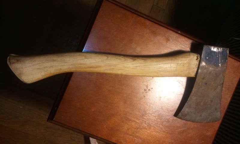

I found this unmarked hatchet at the flea market for $3 and tested it with a file, it skated on the edge and bit good further back. Haft was broken inside the head, but I my try something out with it.
The before is untouched, "barn fresh" condition. Sorry about the crappy pic...

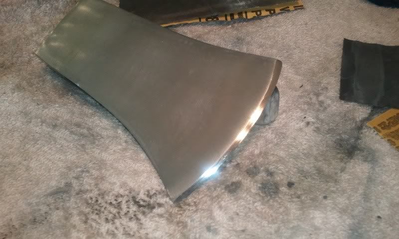

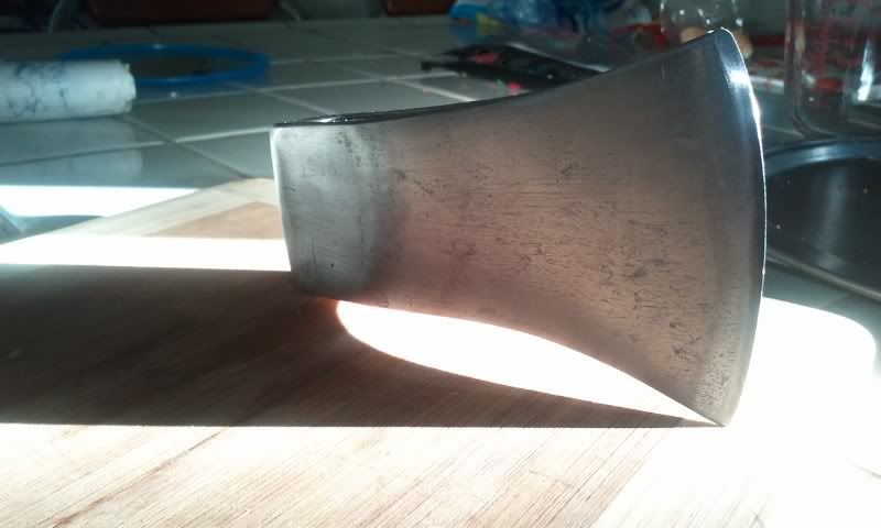

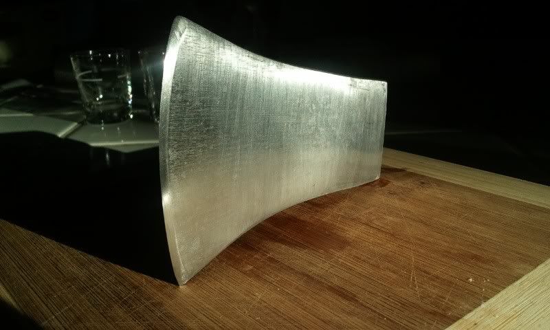

And this is after a couple of hours with some 220 emory paper, a small rubber sanding block and TONS of elbow grease! I started off with the brass wire wheel to get the paint and rust off, then re profiled the edge to remove the chips with the #150 stone on the bench grinder. Used a very large coarse cut file to smooth out the face of the poll and get rid of most of the mushrooming. All corners are chamfered.
The head weighs 1lb 6.65oz. This weight should make a good chopper, it has nice thin bevels and decent edge geometry at the moment. I will finalize the edge last. I may etch some designs into the head, add some paint here and there, just have fun with it. I like doing stuff like this.
