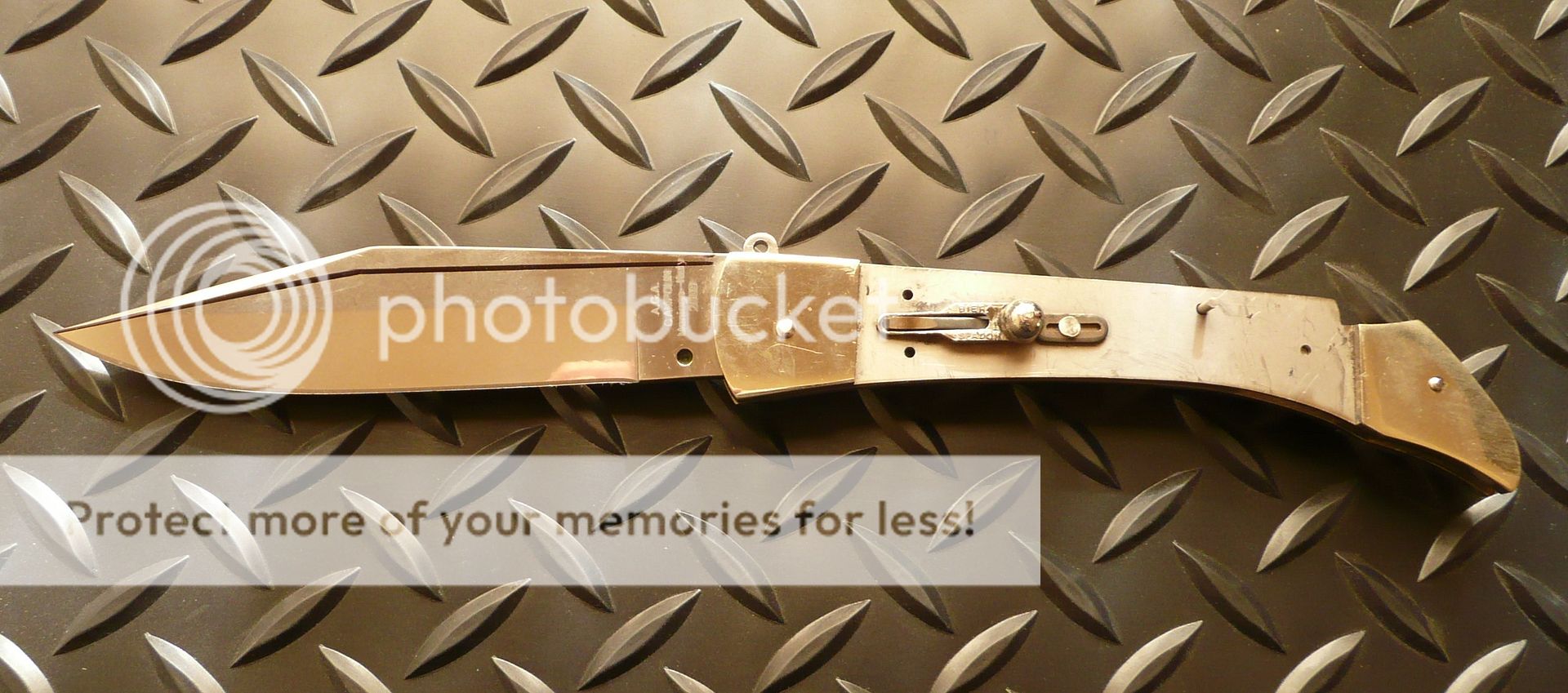

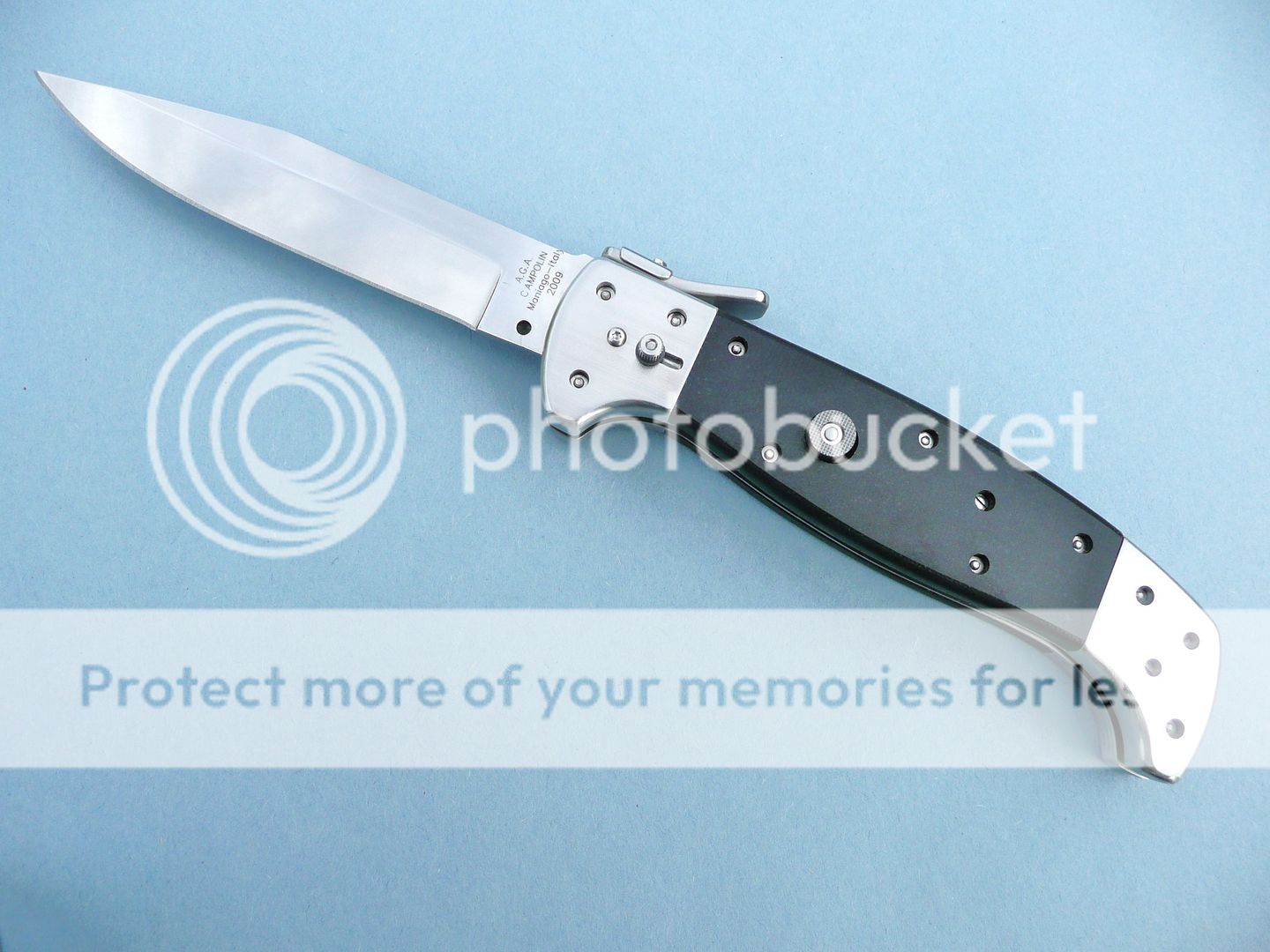

And here's an example of my work. Top pic is the original knife. Bottom pic is what I made it into.
