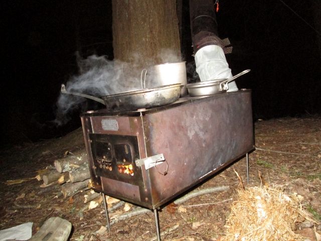

On the ground near the stove is the cedar bark being fully dried. It was a but damp from days of heavy rain. The bark was also put out in the sun the next day. I had to use a stick to keep it from blowing away. Basically I babied this stuff until it was needed later on in the trip.

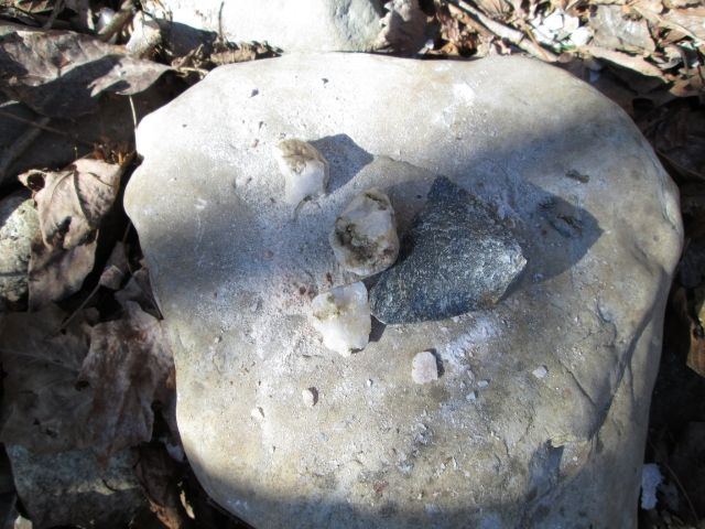

For steel to toss sparks I would need a sharp rock. One of the best places to find good rocks is a river bank. I wasnt sure what the black speckled rocks were. Maybe granite but knew full well what quartz looks like.
Dropping a large rock on a smaller one is clearly complex bushcraft. We could spend a few thousand words discussing the forces of entropy or simply just smash those rocks! The best way to check if the shards are good is to test them on site with carbon steel. If striking the rock and steel together on a sharp angel produces sparks odds are something was done right. In this case both types of rocks worked. Are these rocks equal to the best English flint? Maybe not but the fire wont care. On a side note all joking aside I try to close my eyes and look away before the impact just incase a chip of rock somehow hits my eyes.
