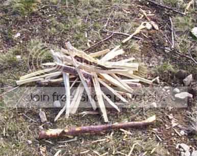

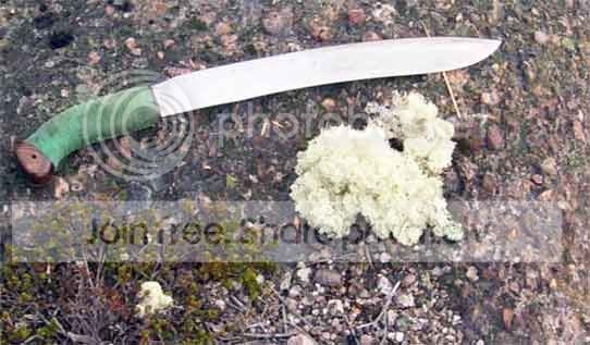

I passed lots of birch and pine pitch trees on a hike, which is kind of amusing, when you don't want it you trip over it. I check this moss, which is wet, but is very airy by nature and it actually burns (match). You can hear the water burn out of it. I ignore that and find a large piece of deadfall and pry it apart and then hack out a large chunk. It is wet for a good ways inside and I eventually end up with a small piece similar to a deck of cards which I split up into really fine sticks and then I feather a few :
This is really dry and enough to get the small diameter wood which is just damp burning which I gather by poking around under cover and avoiding the really wet wood, being careful not to hit the large branches and send down a shower of drops which make everything more wet. There is lots of dead wood around, and it takes about a half an hour to gather up enough. Generally you prepare tinder last but in this case the sun was up and overhead and I was hoping it would dry out the small splits even further as I had them spread out on the rock.

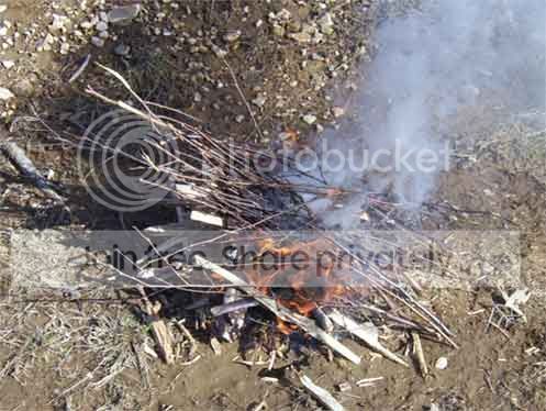

This fire was decent then and once all that wood burned down to coal it was providing enough heat so that it would burn freshly split fir :

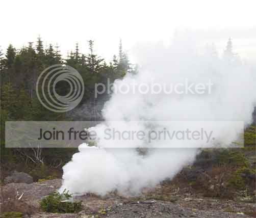

The wood was spitting and cracking, lots of water in it, but it was burning. There was also lots of heat for it to serve as a signal fire :

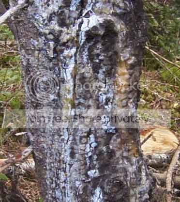

The boughs were wet, but most of the water had been knocked off them when they were limbed off the trunk anyway. All of that eventually burned right down to coal. This is a lot easier and faster with the right wood. It is really easy if you get lucky and find something like this :
The pitch was over one inch thick in places, combine this with some birch bark to get it going and :

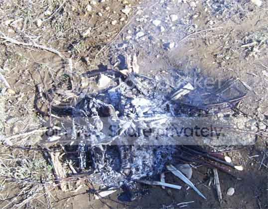

If you look closely you can see a piece of unsplit birch in the middle of the coals which pretty much ignored all the fire around it. Note none of the small limbs burned outside of the main coal, way to wet for the flame to travel down their length. If I was needing to keep a fire going for some time I would have a lot more wood cut down before the fire started and split and use all the heat from the fire to dry it out. Split wood which is exposed to that level of heat can produce a summers worth of seasoning in just a few days and be fairly burnable even in a day.
