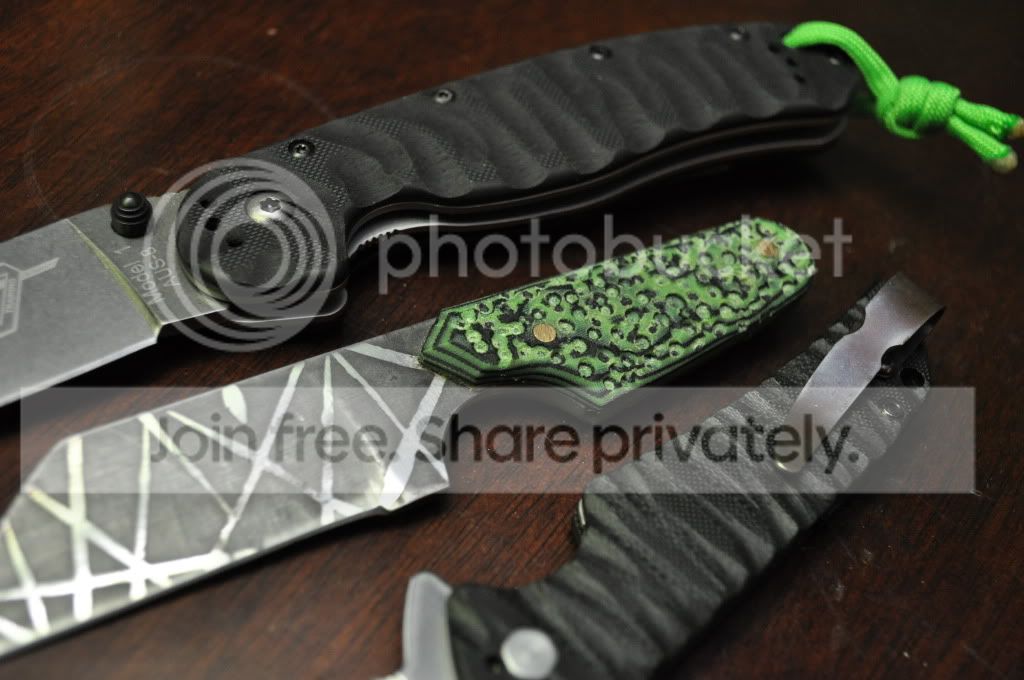

Hi guys. Well, I've been modifying (file-work and sculpting) stock G10 and FRN scales for quite some time now and decided I would begin making my own scales from G10 and maybe Micarta eventually. I ordered a couple sheets of different color G10 at 1/8" thickness as well as some .030" sheets to use as spacers between the scales and liners of the knives. So, I have some questions to ask those of you with some more experience.
1.) Any general suggestions with methods to use to sculpt G10? I use files and a Dremel right now. Any Dremel bits that would be useful to have?
2.) I plan on selling my scales eventually (after upgrading my membership) so for a set of sculpted G10, what would be a fair price to ask? What would be a good price for a set plus G10 spacers? I was thinking $30 for a set of sculpted scales and $35 for a sculpted set w/ spacers. Am I way off base with these?
3.) Any other general suggestions?
Thanks in advance for any info guys. Below are some pics of my work. Just some modified stock scales. Also made the clip on the skyline.

I can't help with any of your questions because I honestly have no idea. But, how did you do the texturing on the scales you have in the picture? Dremel?
Well for sculpting I would get sanding drums in different grits, files are good as well. Maybe some ball mills and rotary files. Do get a decent respirator an use it.
I like working with G10 much more than Micarta. It is a bit more messy and does have some health risks. I have been using disposable masks but I think i'll have to get a respirator. The two top ones in the picture were done with a Dremel. Top one with a sanding drum and the green one with an engraving cutter bit. The Skyline was done with a round metal file. It is much less messy and you do get more control but it takes a considerable more amount of time. Thanks to everyone for the suggestions. Fast14riot, I'll have to try that formula. I will post pictures of my first set once they're done. Thanks again guys.
