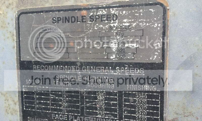

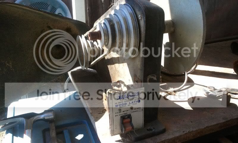

Well I have had this wood lathe at my parents house for years, and the tailstock won't center anymore so it hasn't been used in a while. Everything else is fine, though. I have a 9" disc for it, and it is set up for outboard turning, so if I can find a disc or faceplate to mount on the other side with 3/4-16 left hand thread I won't have to worry about wiring a reverse switch right away. I just pulled the bed off and viola!
Its kind of hard to read the speeds but they are 575, 980, 1560, 2520, 3580. This thing should work well for knife making after I build a work rest. I think I can find an old sander with a tilt table at the flea market to rob the table from for this.

Not to be a spoilsport, but I see a problem with the motor type and placement.
You could probably order a disc from Rob at Beaumont in the desired thread.
It seems far cheaper to just use a reversing switch if the motor is reversible, and stay with one disc.
How I might deal with some of these issues:
1) Use just the existing disc, and turn the motor 180 degrees. Wire it with a switch for forward/reverse rotation. That will move it out of the grit/dust path. You would have to reverse the pulley on the lathe shaft for them to match up right, or mount the motor on a hinged and sliding plate. That would make speed changes easy and fast.
2) Changing the motor to VS will eliminate the whole pulley and motor placement issues. Using a TEFC would be advisable. The disc should be reversible that way,too.
Yeah I know it is less than ideal. I was wondering about mounting it transversely but haven't pulled it apart to see how easy turning the motor around would be yet. Also with threaded spindle ends I don't think reversing would be a good idea. That's why I was going to run a second disc. I have a tefc 1hp 3450rpm 1ph dayton motor that I know is reversable that I may make a disc grinder with a jack shaft and step pullies at some point, but I don't have the capabilities to weld.

Yeah this is a pretty popular lathe, it's the Craftsman lathe as well. I have all sorts of tooling for it including about 10 faceplates, but they are all RH thread. I inherited it from my granfather about 7 years ago or more when he passed, and he bought it in '84. So if he had a LH faceplate for it I don't know where it is. I have been checking all over the net, leevalley, wodcraft, woodenpost, sears parts direct, etc and haven't been able to find anything yet. Although I have found interchangeable hubs with the correct thread pitch. If I can find even a 2" or so faceplate I can mount an aluminum disc to it. Hell if someone could turn one for me that would be great. I can draw up a working drawing if someone needs as well.
Another thought would be to have a new spindle made that is 5/8" keyed on the outboard end to accept standard discs and just wire a reverse switch and leave the motor where it is. I have an exloded diagram with part sizes so maybe ill look into that as an option well. I just don't have the funds to blow on a 2x72 or even a 2x42 right now. I have this and love to tinker with things, so I will try to make it work.
