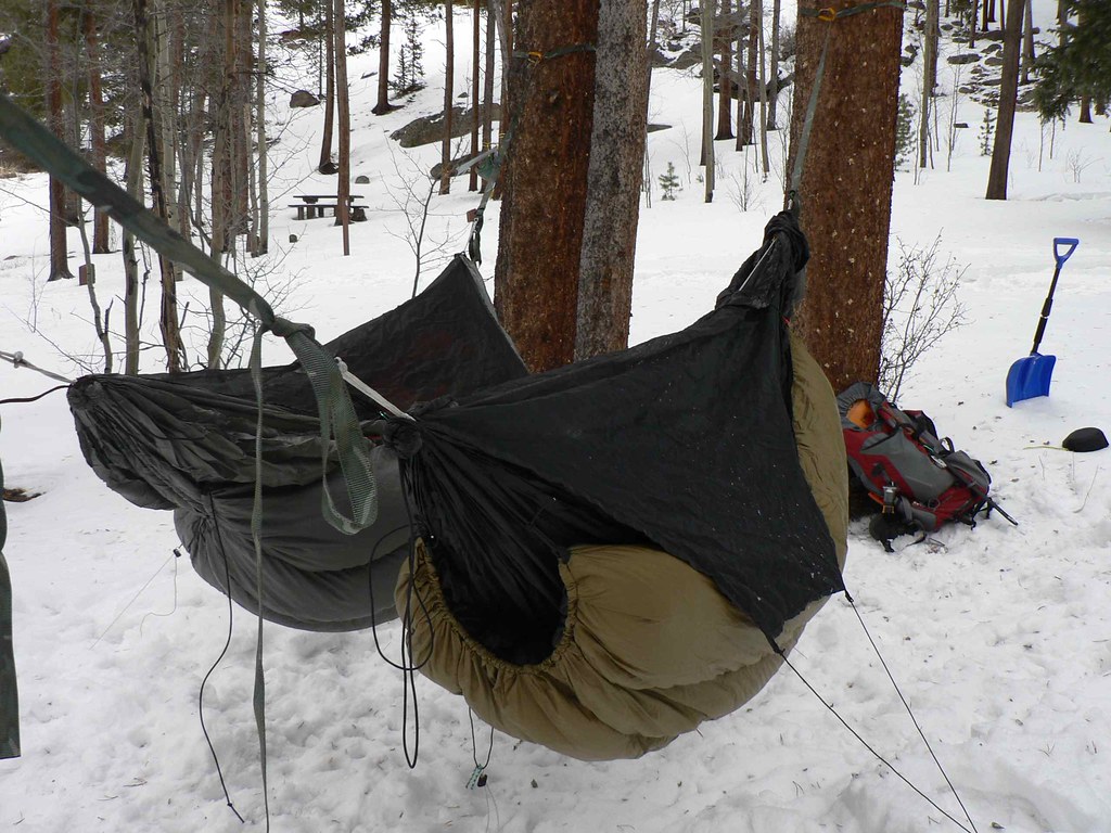

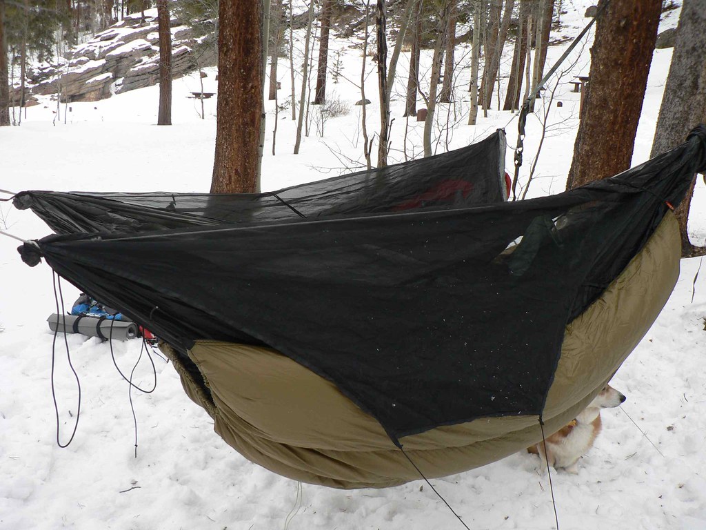

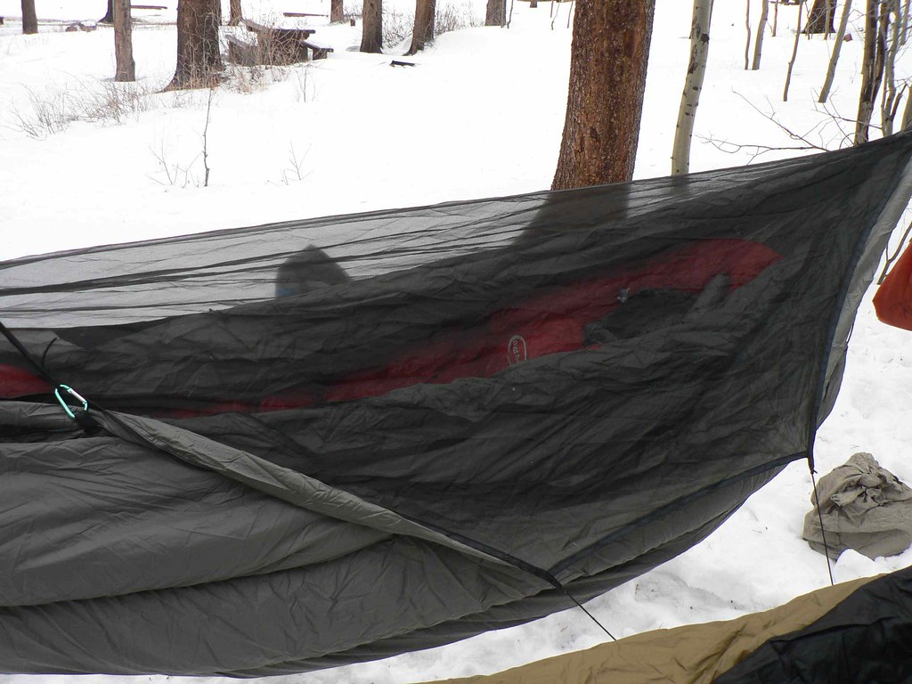

Still, we got to spend a fun couple of hours out in the woods, enjoying the cold, and I got a few good pictures of my hammock setup, so I figured I would share them. In a nutshell, the main thing you need to consider when staying warm in a hammock, especially in sub-freezing temperatures (we were expecting somewhere between 0-10F ), is insulation underneath you. A sleeping bag or quilt will work fine up top, but you need to insulate your butt and shoulders or you'll freeze. In our case, we used underquilts, which are a sort of specialized half-sleeping bag, filled with down, which are suspended UNDERNEATH your hammock - that way, they stay fully lofted, instead of being crushed by you laying on them, and provide maximum warmth. Here's what they look like:

I use my Clark North American in the winter. I stuff some of my extra clothing in the pockets, and use a Big Agnes lost ranger bag with a sleeping pad in the sleeve (I use a Zrest Pad). I have stayed comfortable in this setup well below 0 degrees. However I sleep very warm.

A sleeping pad provides the same effect as an underquilt - extra insulation under you. I've gone down around 0 with nothing but cheap walmart foam pads. The point is to get SOME sort of insulation under you.
The benefit of the underquilt is light weight, compressibility, and not having to worry about rolling off your pad :p

The Underquilts were homemade, probably about $150 in materials in each of them (that's premium 850 and 900 fill power down, and ultralight momentum 90 fabric - with cheaper materials or stuff scavenged from old sleeping bags it can be done much cheaper)
The tarp is an OES 12x10 custom, and also ran around $150
The hammock is a Warbonnet Blackbird, and runs about $170
Weights are: 26.5 ounces for the tarp including stuff sack and rope, 36.2 for the hammock, storage sack, webbing suspension lines and climbing rated carabiners, and 22.5 ounces for the underquilt and suspension.
You can go both lighter and cheaper, if you so desire - a simple travel hammock with no bug net, a thermarest or walmart foam pad for under insulation, a smaller generic brand tarp, etc...
My entire hammock setup is hand-made in the USA, either by my fiance, or by cottage gear makers. That adds to the cost, but gives you premium quality gear while supporting a fellow hobbyist. If you just want to try it out, a couple bucks worth of ripstop nylon, some rope, a blue foam pad from walmart, and a plastic tarp will give you a taste of hammocking, and can be done for less money than I paid for materials for my underquilt
I have gone down to 3 degrees F with no underquilt, just a couple of pads. It generally works, but every hour or two a shoulder or elbow would slide off the pad and get cold, waking me up. I wish underquilts were cheaper, because they are a great solution.

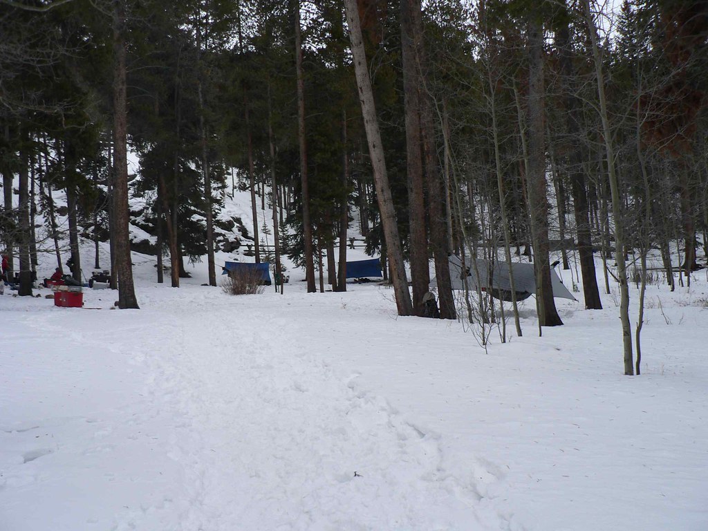

Yeah it sure is - the campout was actually at a group hammock hang, organized by the people at hammockforums.net
Brandon, the guy who makes warbonnet hammocks, is one of the forum members who was there. It was cool to be hanging out, sitting around a campfire talking and eating, with the dude who made the hammock that I've been using for over a year. There were more than ten people camping out in hammocks, and several of us had Blackbirds.
