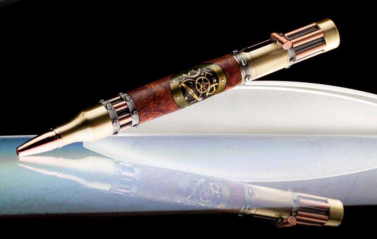

Hi folks, well I went to the Ashokan Seminar this Sept and had a great time, didn't have a lot of money so I didn't come home with any knives, although there were some sweet ones there, but mainly it was a Sword weekend and lots of great lectures and demo's went on.
Stacy Apelt was there and besides being a bladesmith, he also does some, well lots! of other interesting things that he sets his mind to, very cool stuff. But I saw this Steampunk pen, ( also this was the FIRST time I've ever even HEARD of the term Steampunk !! but everyone I showed it to smiled and said kool...steampunk...guess I'm really getting old lol ) I knew I could not leave that with him, I don't know what drew me to that so much but I could tell it took a while to accomplish such a task as inlaying all those watch gears and hands.
Here's a couple shots taken of it tonight;
The brass lever thing is just that, you pull that down and it locks in place keeping the pen exposed.

VERY cool pen, while it will make your shirt pocket drop to your belt, it will be a great pen to have at my desk !!
And I did figure out what that inlay reminded me of, the movie "Tomb Raider" with Angelina Jolie where the clock mech explodes out showing all the gears within, of course I could just be remembering Angelina...but I digress ;)

Indeed he does, he said he had a friend take some gears from a watch and thin them down in order to get them into that arrangement, quite delicate work!!!
In order to light it up and 'see' inside, I used a polarizer filter on my lens that cuts the reflections and reduced the glare.

No friend involved in the watch fitting, I did all the work. The friend I mentioned was my laser cutter who cuts my inlay barrels and other wooden parts.
The afzelia burl pen barrel had a laser cut oval opening and a thin blackwood sleeve that fit inside the barrel ( with a brass sleeve inside that). There was a gold plastic ring that had to be fitted to the opening to make the frame. I drilled that out and fitted silver rivets to retain the oval frame to the black sleeve.
I took the gears from a ladies Elgin watch and made a mandrel the curvature of the black inside sleeve. I ground off the upper staff and any protrusions on the gears and parts, and annealed them. I then used the mandrel to curve them to the exact curvature of the pen sleeve ... even the spring. I drilled holes in the sleeve and placed each gear in place , using the lower staff to secure it in place through the very tiny holes drilled through the sleeve. I added the screws and small parts like hands last. The whole assembly was then filled with clear coat epoxy. After that, the barrel was turned to final shape. The final sanding brought the parts within .5mm of the surface.

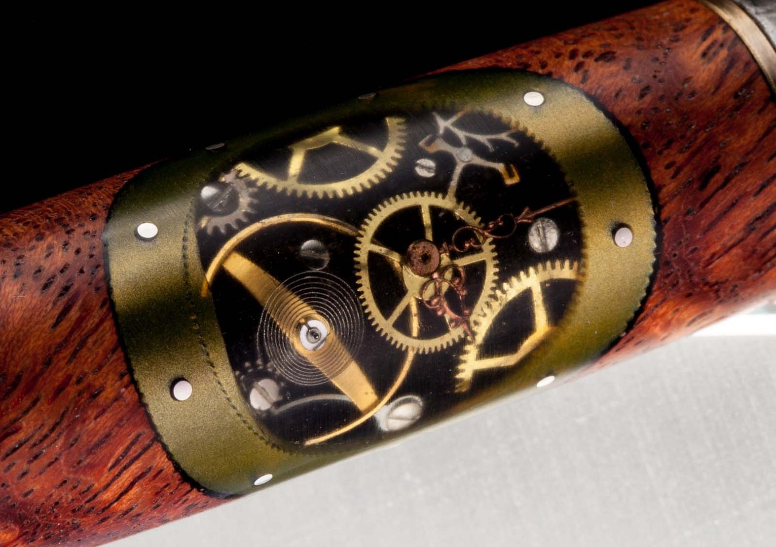

So are those actual gears in the pen? Almost looks like an image of gears.
Neat pen for sure.
Yes actual gears from an Elgin watch, very well done!
G2
Thanks, here's a closeup crop from that photo, the hands are pretty cool too ;)
