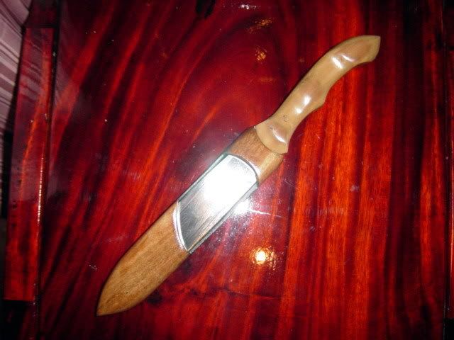

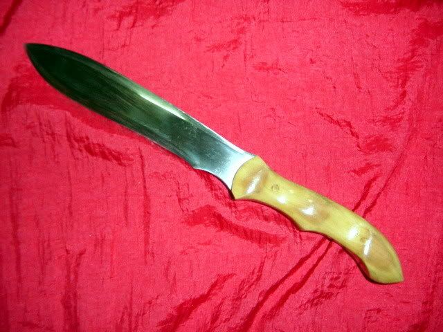

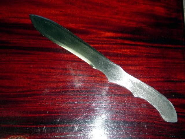

Nok and I started making this fighter yesterday her first steel blade.
13" over all
8" double edged blade
Carbon steel
Not to bad for her first try. Charcoal fire harden, quick quenced in olive oil (don't know why some guy on blade forums said there was a reason but didn't say why). Man allot of hand sanding to get the scatches out of steel now I know why we like to work with wood lol
Handle : some kind of thai wood
Bamboo thru pins to hold the scales on
