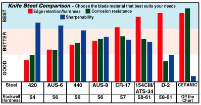

The charts are cool, I'd forgotten about them. Too bad they don't cover the sandvick steel that he's asking about.
440C is quite a bit better for edge retention than the 440A shown on the chart. It (440C) has much more Carbon and can be taken to a higher HRC (Hardness Rockwell C). 440A=0.6-0.7 % Carbon. 440B=0.75-0.95% Carbon. 440C=up to 1.2% Carbon.
