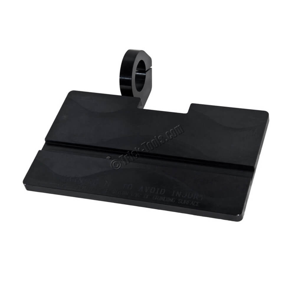

Grinding thin stock is VERY tricky, especially if you use a work rest (I do). The piece can get sucked between the belt and rest with terrifying (and piece-wrecking) results. Keep your wits about you and you'll make some amazing kitchen knives.
If your work rest is "Notched" such that the sides go a bit past the belt, you will have a hard time wedging a blade between the belt and the rest.
@stacy thanks, i'll have to get one of those rests. such an obvious idea in hindsight :P
