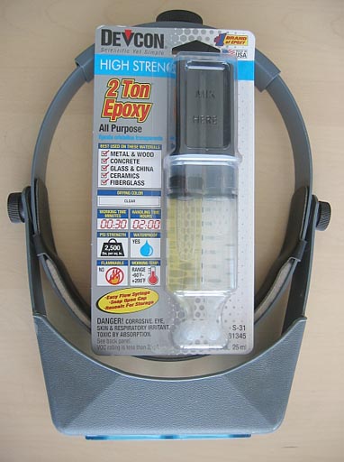

I use carbide burrs in my Dremel to nick the tang everywhere that will be covered by the scales. Once you have squared the surface of the scale material to be glued, use another burr to cut and nick the scale. This gives the glue a place to migrate to as the clamps squeeze out the excess. I use spring clamps and not c-clamps. Wipe everything to be glued down with acetone.
Once I have the scale and tang glued and ready to be clamped, I use a wrap of waxed paper to keep the glue off of the clamps and gluing area. Waxed paper lets you see through to your work to check alignment and such, it doesn't stick, and it's cheap. I'm using the same epoxy and it works well for the application.
I use this epoxy:
First of all use the "2 ton" variety of epoxy, fast setting stuff stays gooey (in my experience)I will drill a couple of very shallow impressions in the tang and on the insideof the scale to form "epoxy rivets" I also rough the sides of my rivits so the epoxy will grab between the rivets and the wood. as for the mess, i just put down lots of scrap paper, and cut/sand the hardened epoxy off when final shaping/finishing. I clamp it in a vise lined with several layers of paper to keep the epoxy from attaching the knife to the wood blocks of the vise. As for hardness, I crank the snot out of the vise, If I can see a gapbetween scale and steel before glueup it's not fitted well enough, if I can see a gap once glued up it's not tight enough.

I am with Sunshadow. I want no visible gap, and I use Devcon 2 ton. I honeycomb some tangs, drilling "bridge" holes for the epoxy to fill. I once had to replace a set of buffalo slabs on a tang done this way, the owner wanted ivory, and I had to burn the grips off. I could not break the bond with a hammer.
I use this epoxy:
This is basically what I do and use the devcon epoxy. I use the dremel with the metal cutting disk to cut shallow slots in the tang and handle material. I also dye the epoxy the color of the spacer material I use between the knife and handle material.

Now I am wondering how 2 ton epoxy is characterised? is it 2 tons weight pulling apart two glued together plates which are 2m x 2m or two plates 2cm x 2cm?
