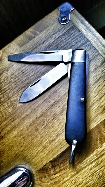

Here's a pic of the knife. It's in very good condition for an old carbon steel model. The only real issue with the knife now is that they never really finished it during production. The scales and back spring don't mate up with the brass liners on the outside of the knife. Does anybody know if I can just throw this on my belt sander with a wet/dry belt, and slowly grind things down flush, or will that end up melting the Delrin scales too easily? Pics of the Craftsman 9561 coming up tomorrow hopefully.

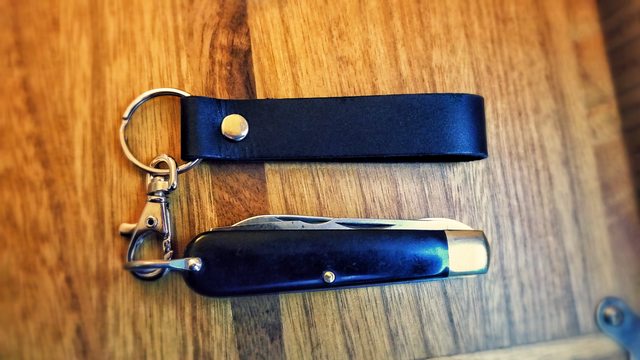

I'm liking the TL-29 enough, that I broke out the leather working kit last night, and made a matching belt hanger out of some old latigo leather I had.

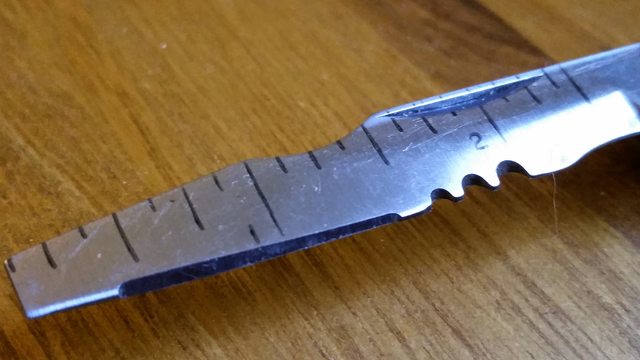

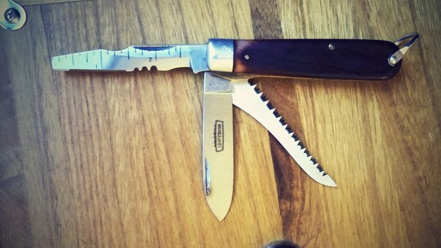

And here are a couple of pics of that crazy Crafstman knife. The screwdriver is VERY nicely done. The wire strippers are actually sharp and well thought out, and the ruler is a welcome addition. And who doesn't love a wood saw?

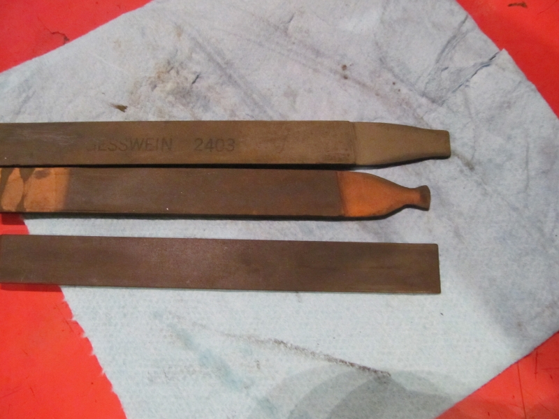

I used gesswein finishing stones that were thinned to fit on a bench grinder. They will shape themselves once you start working & that just makes it easier to get a radius.
In the picture only the right side is finished.
