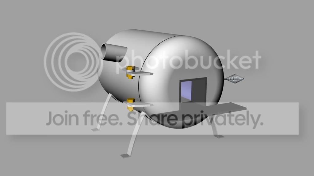

I'd love to see some pix of your door, hinges and latch(es)!
I still haven't actually made my hinges, but they are fairly simple. I am also working with a 33# tank and not a 20# tank so I have a bit of flat space to work with. The thing for me to remember when I am welding all the parts together is to keep everything level as humanly possible. If I let one piece come out of line a little bit the whole works will bind and be a bugger to open and close.
I have everything drawn up in my cad program, I will render a couple of pictures of the hinges and latch.

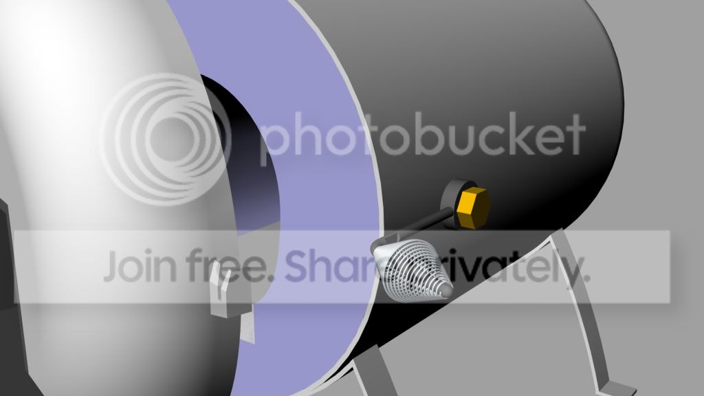

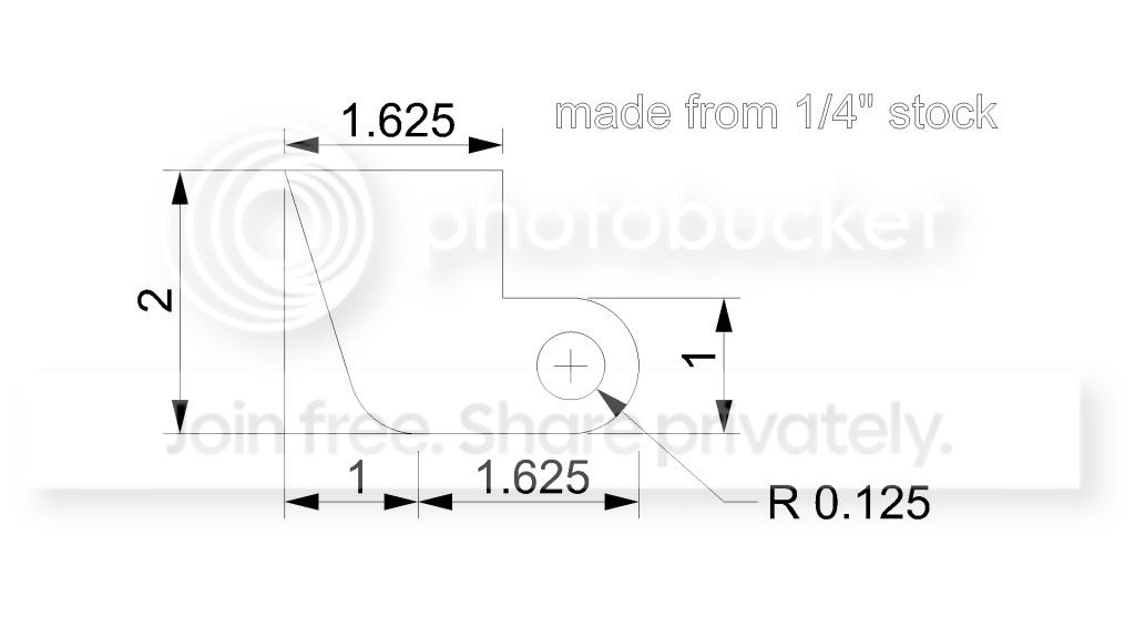

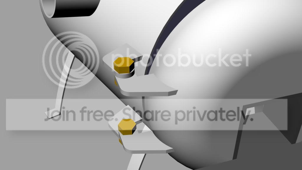

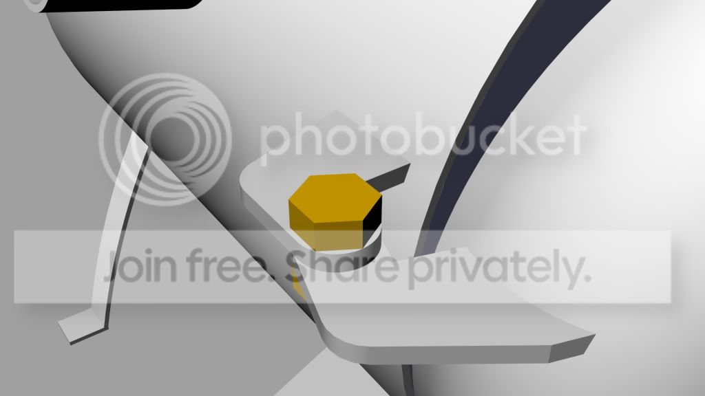

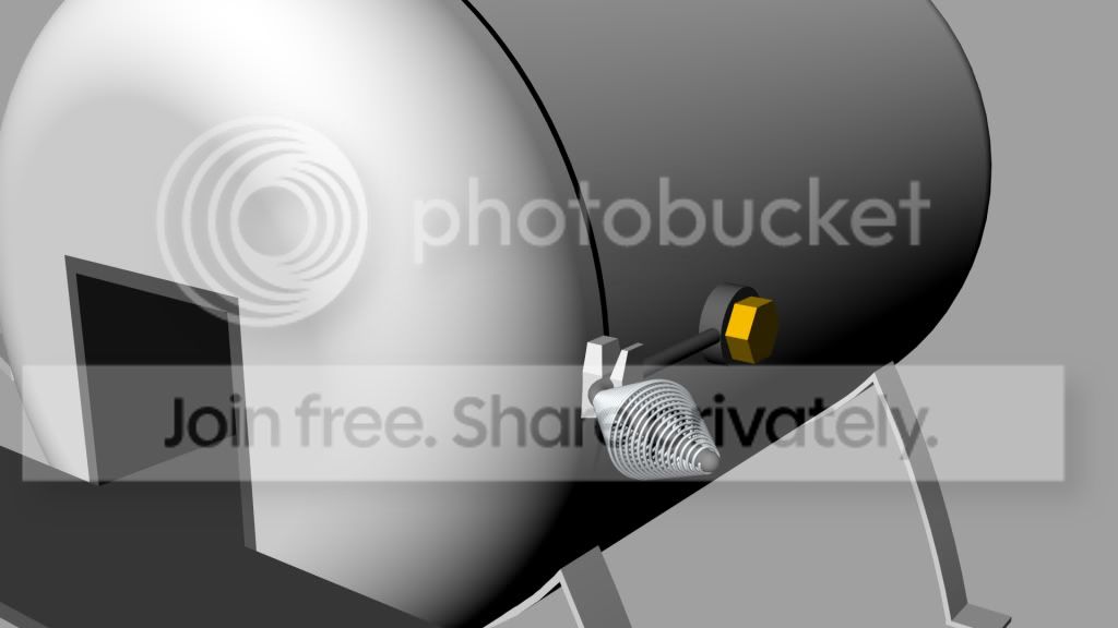

OK so here is what I am thinking for hinges and a latch. Two things to keep in mind is that my drawing isn't exact, where the door side of the hinges attach is actually flat not a radius like in the drawings, and I know there is no handle on the door. What I am thinking of doing there is to just drill a hole through the shelf so I can stick something into it to open the door. I am also considering adding a stop to the hinge to keep it from swinging all the way to the side. In a perfect world the door will never be opened while the forge is hot, so the handle isn't really needed, but we all know that the world isn't perfect.
The latch catch I am just going to make out of three pieces and bolt them together, if I had a mill I would machine it
