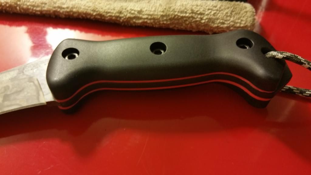

I finally got time to fatten up the BK4 handle. I found Red plastic folders in a clearance bin and brought a few home. I cut ten 2"x6" pieces, drilled the holes for the scale bolts and lanyard hole, bolted all ten pieces between the two scales, trimmed with an Xacto knife, sanded with 220 grit wet/dry paper, buffed with a Dremel, and thera ya have it. Not perfect but cool anyway liners. I dig em.
