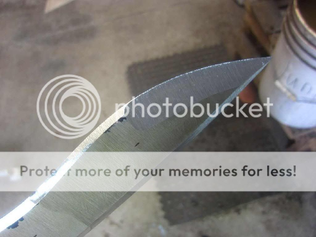

Have you tried this stock removal method/trick shown by Philip Patton? It may allow you to remove a good majority of the stock before you have to set the primary bevel grind, making it easier on your arm muscles. Or maybe it's time to start a push-up regimen lol?

He grinds a 45 degree angle pre bevel near the edge using a worn belt, so when he grinds the main bevel with a new belt, it cuts better and there is less overall material to remove. It appears to work very well on long, wide, curved blades like the one pictured. It's similar in theory to forming a convex grind with a file, using multiple passes. If you used this technique, your passes on the grinder should theoretically go much faster, which translates into less work on your arm muscles that are being forced to maintain such a wide/awkward hold on the blade. Just a thought, since you are experiencing muscle failure in your left arm/hand. Then again, a simpler option may be to wear a wrist brace/wrap to assist the muscles with supporting the weight of the blade.
