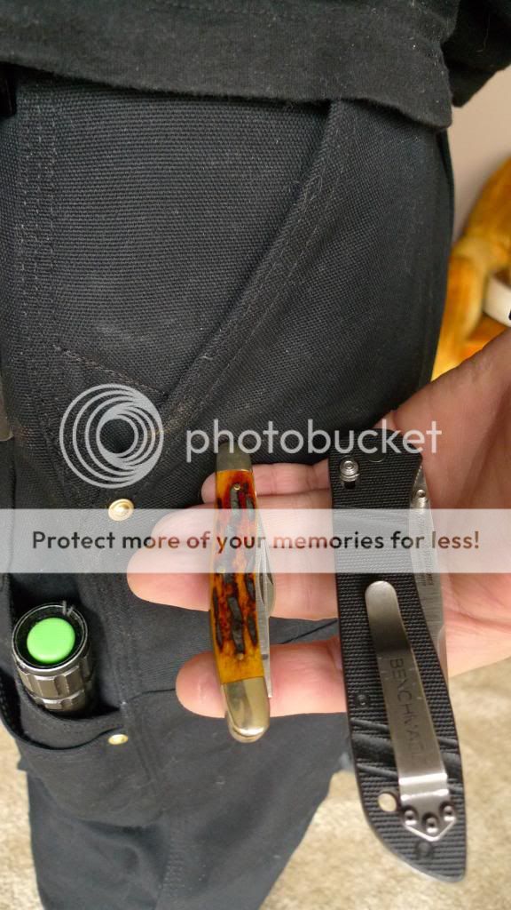

Because I started working at a company that has a no-holes policy for clothing I had to buy new pants. Same problem, just a bigger change pocket (went from dickies carpenter to carhartt double knee carpenter). One line of stitching and the stockman is now held up and away from the BM710 so they don't actively rub against each other, and because the pocket is at a heavy slant I draw it without having to pass by the stockman at all. Because the coin pocket is so huge on these I'm not losing much usable space, but I'm saving a ton of wear and tear.
Here you can see the triangle stitch a little better

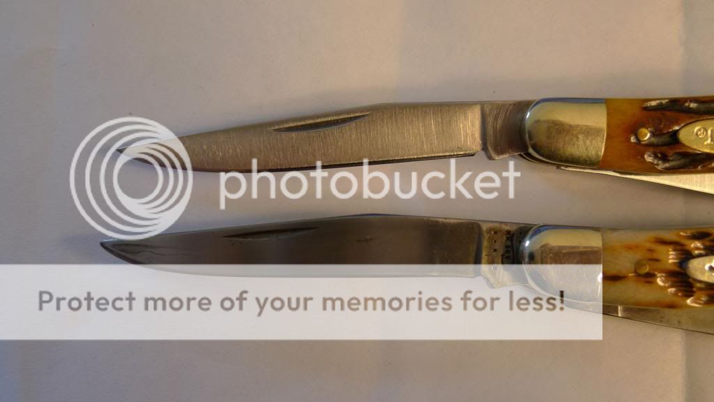

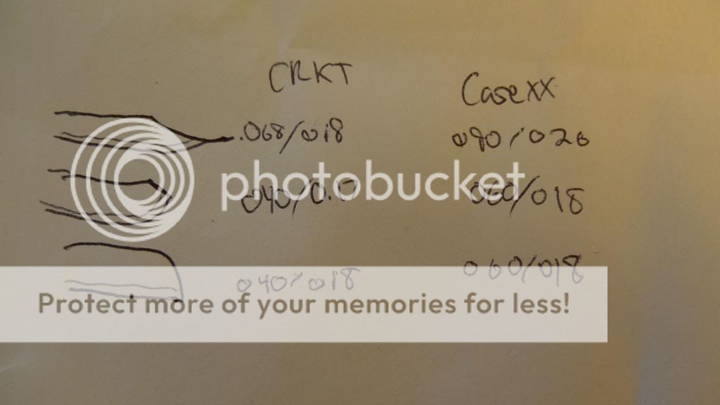

Yes :) I went and measured it against my case medium stockman and turns out I did not actually grind them to what I had thought I did. I set all edges to roughly .018" thick. I vaguely remember aiming for those numbers but having a hard time acheiving them on my sloppy 4x36" craftsman sander.
spine/edge thickness measurements

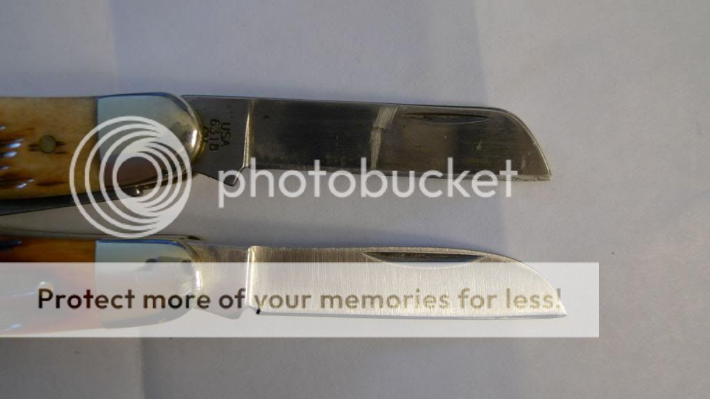

The flare on the sheepsfoot is much more pronounced and high on the case

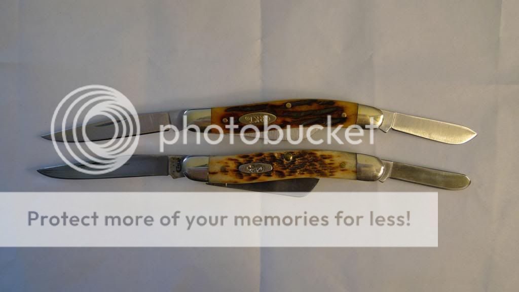

The crkt has offset ground blades that are thinner, and a very mild curve in the center of the sheepsfoot, where the case is bent at the tang and rubs against the spay.

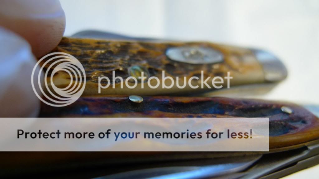

some of the fit and finish aspects are better on the case, such as the pins that are open and catchy on the crkt. I had to sand them down so they wouldn't grab onto things. The action on the crkt is much smoother, much easier though. The thumbnicks are also deeper.
Altogether I feel that the crkt is a better production knife. It's smoother action, more compact but with more edge in places like the spay. It has a tip thats pointier on the clip, and the spay doesn't rub against the sheepsfoot. That is, in it's current condition. When it came to me everything was the same, except the edges were almost as thick as the spines. Seriously, the grinds were almost there for cosmetics rather than functional geometry.
