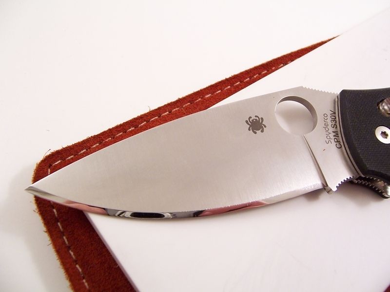

Wonwin78 I was you a couple of years ago here. I started many threads and asked the same questions of how to Achieve a true perfect mirror edge. I got great advice here especially from Jason and it took a while and tons of practice to get the results I wanted. I finally settled upon a good setup that works great pretty much all the time. I use DMT Coarse to reprofile. Then fine and extra fine to remove the coarse scratch pattern and refine the edge. Then polish with Spyderco medium, fine and ultra fine stones. If you take the time to remove all the previous stones scraches at this point you should have a very mirrored edge. But to take it all the way I use DMT diamond paste on leather at 6,3 and 1 micron. It sounds like a lot but once you get the hang of it it's not to bad. You spend most of the time with the coarse DMT to get the bevels just right the rest of the stones is just refining the scratch pattern. And with time and practice with this setup you can get results like this.
