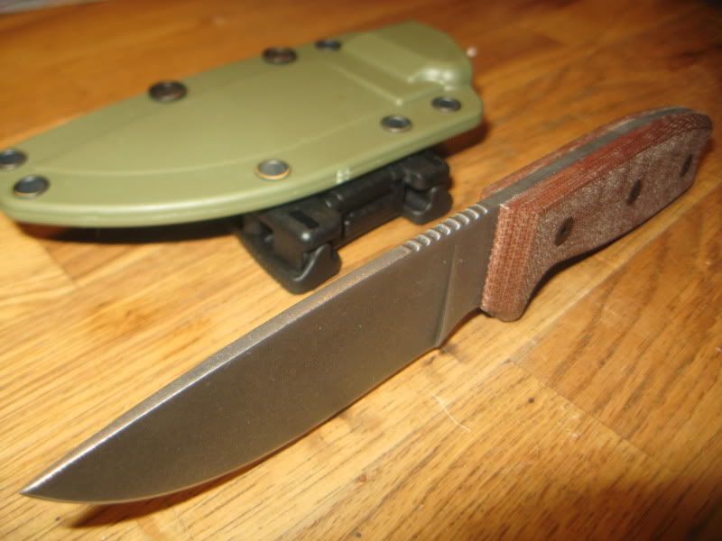

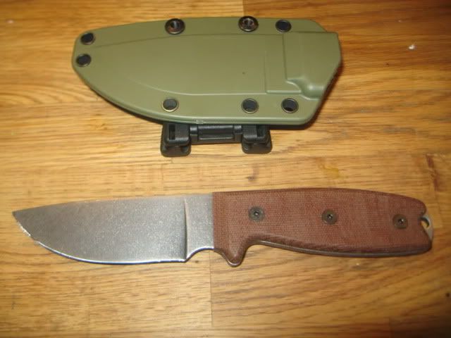

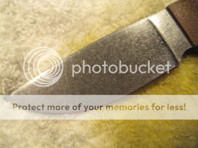

I put stones in a bottle with some WD40 and shook it by hand for ten minutes. No pics of the bottle but think of a Nalgene water bottle. Plastic with a lid. I did not protect the blade or tip with anything. I resharpened when done.
I also used some PCB etch to darken first.
