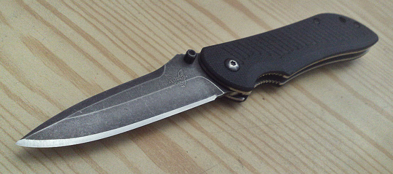

Hello guys, (not positive where this belongs so it can be moved) but what is the best and cheapest way to stonewash my skyline blem blade without ruining the blade, I do have a dry if that helps, seen that before, Thanks
Let me know if there are any other good mods to do, I want this to be my mod knife!

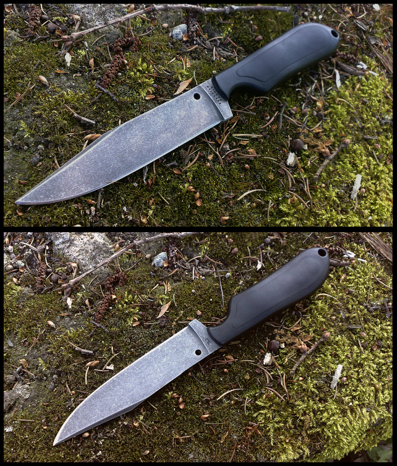

I tried a home stonewash on a Spyderco Ambitious, in a small rock tumbler. It didn't work. :grumpy: I used the knife to experiment on and try some embellishments. Starting with the spine, I tried grinding a pattern in, but ended up just looking like a rough stoned edge. Not completely horrible, but not what I was going for.
Then tossed the blade in the tumbler with some half polished rocks, water, and a little dish soap to keep everything loose. Ran it for a day....nothing. Two more days....nothing. I think maybe it needed a smooth sanding first, as there were micro grind lines on the original blade finish. I thought maybe if enough time elapses in the tumbler, it would eventually wear everything down anyway. Ran for a number more days with more coarse rocks, and some coarse media. The edge was completely gone, and my spine work was smoothed out quite a bit, but still not much (if any) of pattern on the flats. Ran a few more days, then at some time the machine got unplugged by kids, and almost forgotten by me. It sat in the water with rocks for almost a week. When I finally removed, it just had a very dark grey patina, with a few rust spots starting to pit. Tried polishing up a bit, but it was a very deep patina. So I just left it as is, re-sharpened and assembled.

I did my acid sw with some stones, WD-40 in vodka can by hand. Just shake it.
I've refinished my cqc-7 a couple of times with an easy stonewash job.
Smooth out the milling marks with some sandpaper.
Place the blade in a heavy plastic jar for mayo, pickles, etc make sure it has a plastic lid, the blade will bite through aluminum.
Fill it 1/3 - 1/2 full of media. I just used pebbles from a local park. Mixture of limestone, quartz, etc.
I also used a bit of soapy water.
Tape down the lid liberally.
Cover in bubble wrap and a couple old t-shirts.
Run on no-heat in a tumble dryer for 3-4 hours.
Worked great for me. You definitely need to smooth the milling marks by hand first though.
