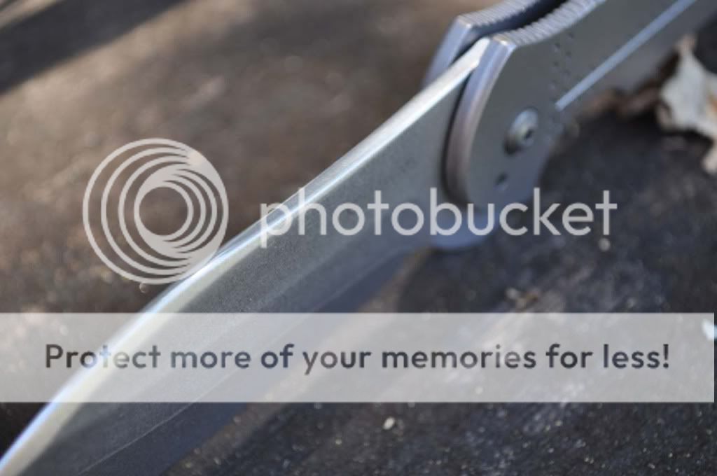

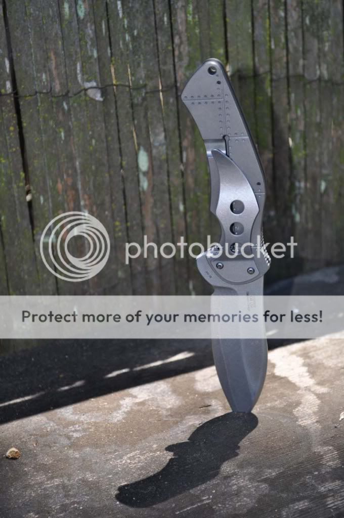

Thought some of you might like to see.
Mirror polished the spine.
Very nice!How did you go sbout doing that?If you don't mind me asking.
I put the blade and clip into a rock tumbler with some ceramic media (lightly abrasive ceramic stones), pumice hand cleaner, Flitz polish and a little bit of oil for about 3 hours, and then I used some 2000 grit sandpaper to polish the spine.
How's the lockup? I'd be worried about the tang area.
The lock up is solid and was in a nearly identical place after the stonewashing. It did have to be broken in again, as the finish did scuff up the locking area. If you think about it some knives have this finish from the factory and the same process applies. The edge was completely killed. Gone.
