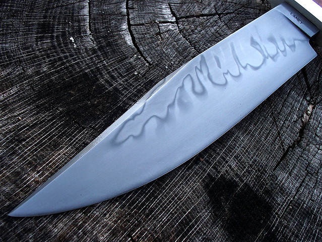

If PROPERLY done a blade with a hamon gives up NOTHING to a fully hardened blade. The key is getting enough of the blade hardened, my general rule of thumb is 1/2 up the blade. I have done testing and by hand you CAN NOT get a properly h/t blade with hamon to take a set. Not only have I tried this (at 180 lbs.) but I watched Jimmy Fikes (at 250 pounds) do the same bend test with the same results.
Now with this said, I see alot of people applying hamons that only have a narrow band of hardened steel with the hamon dipping down dangerously close to the cutting edge, and generally not having enough "hard" steel for a good tough, serviceable knife in my opinion.
To those that dont want to do hamons, simply dont do them, but to say they are "inferior" to any other h/t method is a bit untrue.
Holy Bat Chit Matt that is one of the greatest hamons I have seen! At first sight crazy Arabic writing came to mind. How can you hate a good Hamon?

Yeah, im not trying to make "traditional" looking hamons, Im basically using the clay as a control method, and the "hamon" itself is secondary to me. Do I like the looks, sure, but thats not my main concern.
That is a great outlook Matt! And i will say that the hamon above is outstanding, like flames! Great job. I do appreciate the toughness imparted by a properly differentially heat treated blade.
