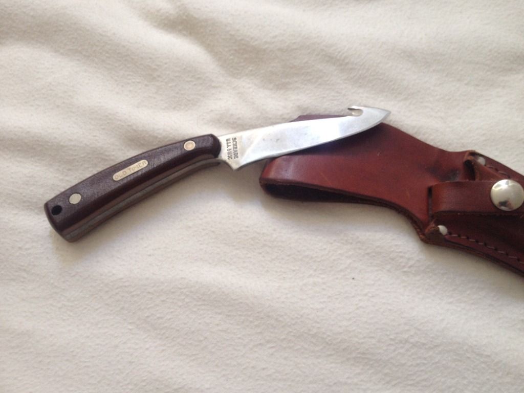

I bought this knife on March first in 1991. I use it for two weeks out of every year for dressing deer and the rest of the time it sits on the leather sheath with a coat of whatever oil is closest to me when I put it away after deer season. No rusting ever. When I got it I did use silicone leather boot water proof liquid on the sheath, so maybe that helped. For four of them years I lived right on the coast of the Puget Sound and it still stayed rust free.
I know you guys love the original Schrades. This one and the SS1 are my only two remaining original Schrades. The rest have since been retired for being worn out.
