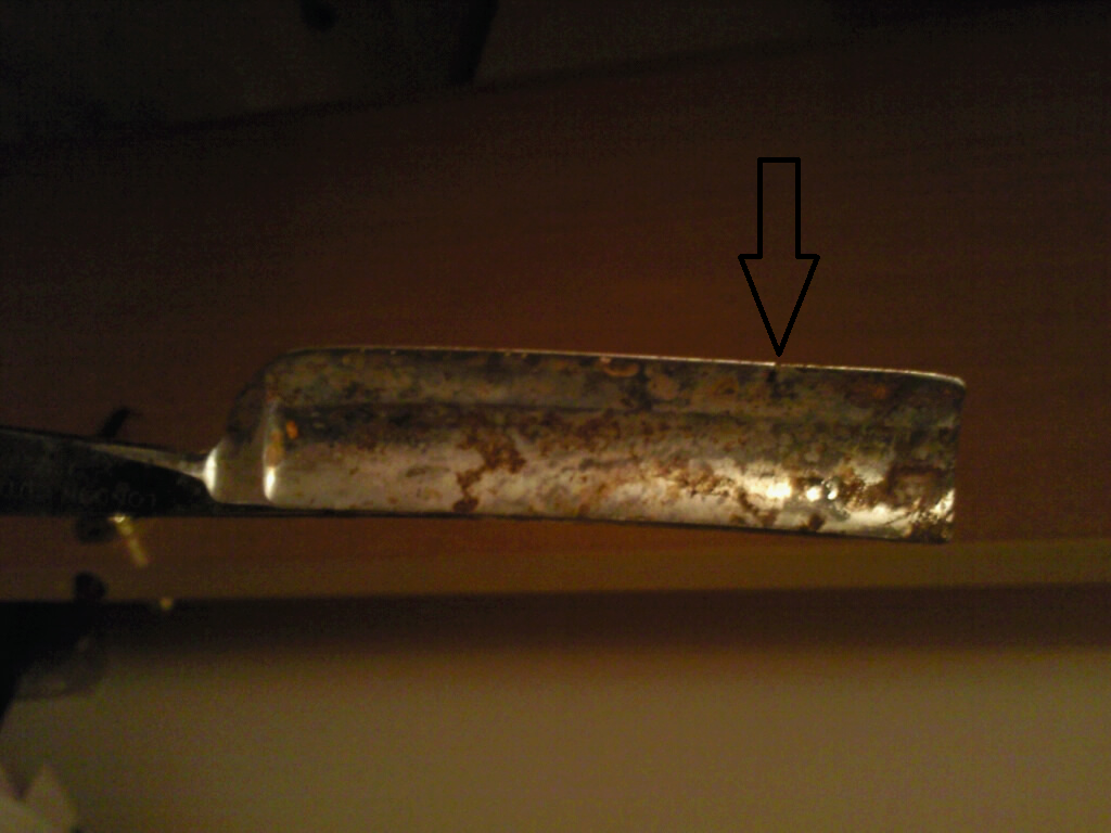

This razor was left in the house my wife grew up in, used by the previous owner who was a very old family friend. The blade has been played with , tossed around, etc and the edge is severely cracked (shown, or attempted to be shown, in photo) all the way to the ridge (I don't know what you guys call it, the ridge just after the blade edge, not the spine).
I'm new to straight razors and I'm wondering is there anything to do besides throw it out? Cut it off at the break? Yes, I realize there is a LOT of rust on it as well and I'm hoping I can clean that off and replace the scales, I'm just wondering if the blade is even salvageable to start a restoration project or if I should just toss the darn thing...

Looks bad....What's a decent razor like that cost $40-60? I'd personally toss it. Unless there is any family value to it.
The only way to save it is to grind off the part that's cracked. Then you might to able to make the shortened portion serviceable. The surface rust doesn't present that big of a problem, but if the edge is pitted it will need to be ground upward until you have clean metal. If you can overcome those issues, why not take a shot at the restoration. A short length of rubber hose make a great backer when sanding the hollows of a straight razor.

Thanks guys, that's what I was hoping to hear - wasn't sure if cutting off the broken end would be acceptable or not, and it needs new scales anyway so I will get on that as well.

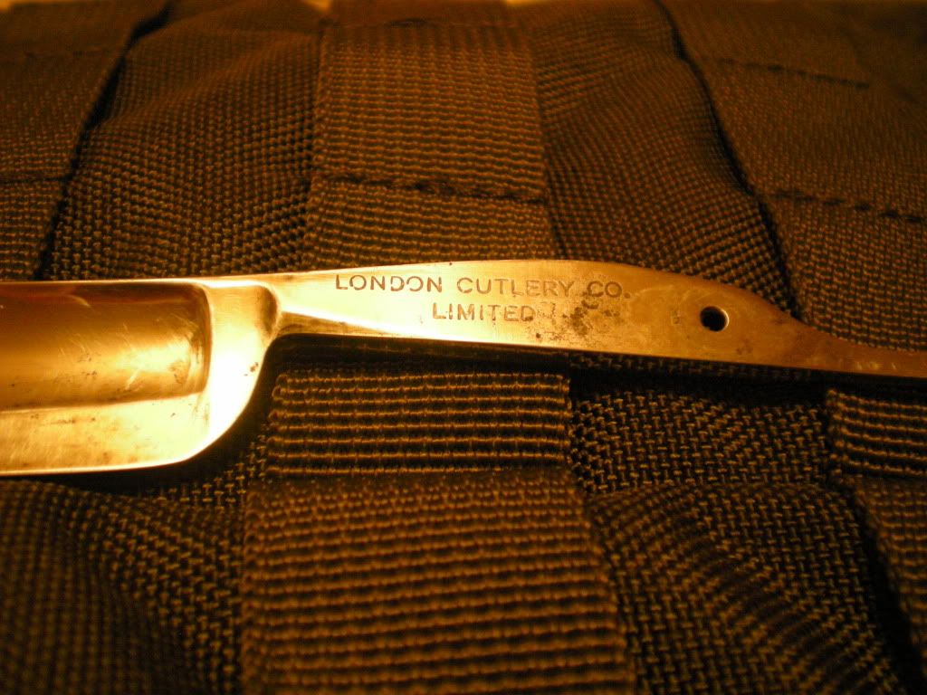

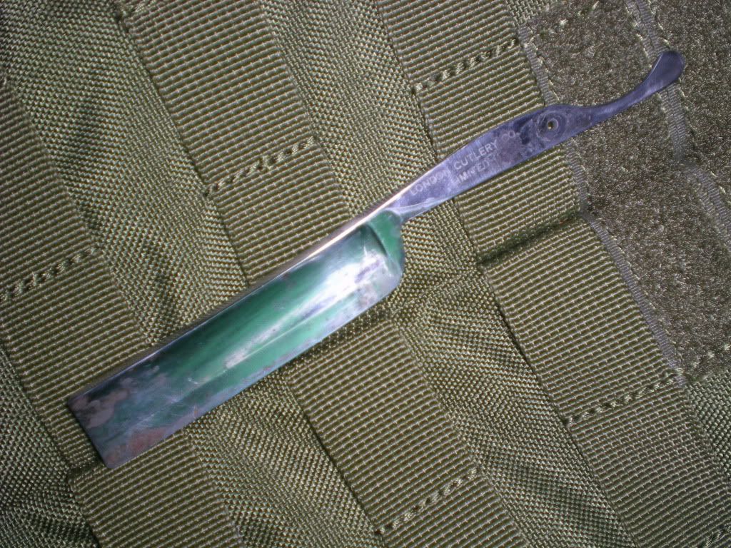

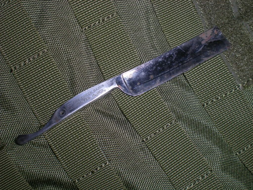

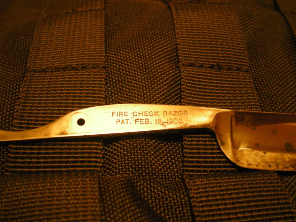

I decided what the heck, I can attempt what restoration is possible and if it works out then great and if not I'm not out anything, right? Anyway, after about 10 minutes with some 1500 wet/dry this is what she looks like. You can actually see the name in her now. On one side it says "London Cutlery Co. Limited" and on the other side it says "Fire Check Razor Pat. Feb. 18, 1902"
Can you guys tell me anything about this razor?
I did grind the tip off and had Larry Andro hone it with a couple others I sent him (he didn't charge me anything for the stubby little guy). I pinned it up but haven't finished the wedge so it's just been sitting. I got sidetracked on another project, an old Friedr done up in purpleheart scales... First resto and I was pretty happy with it!
Usually cracks that are only a 1/8" or less can be honed out. That one looks about that to me but I might be wrong. Maybe throw it in a tumbler with some more abrasive media like walnut or whatever and that should clean it up real nice in about 2 days. Looks good though, I can never throw out a razor unless it is totally messed up and will have no use or collectable value. Nice find though and good work cleaning it up as much as you did.
