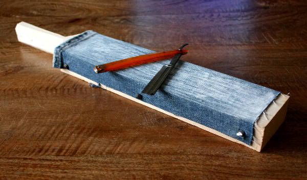

Sadly, I don't yet have a stone finer than 8000 grit, nor a strop. Just haven't taken that financial plunge yet! In lieu of a traditional leather strop though, I improvised one out of a 2x4, denim, and with some baby powder as a makeshift stropping compound:
Several light passes over the strop and the razor is good enough to use on my whiskers!
What about usual leather belt? There are two sides belts with one side covered by thin abrasive and second one is just clean. After finishing on the stones, you will need few passes on abrasive side (without big pressure) and after that some more passes on clean side. I use it regularly to keep my old razor sharp. It works.
What about a big rawhide dog bone? You can soak it and then "untie" it. Then you can attach it to a board, like the denim strop above. You could probable keep it from hardening with baby oil or Ballistol. Perhaps neatsfoot oil mixed with baby oil. Haven't tried it yet. Just a thought.

According to the guys over at SRP, 8k, as long as it is flat, is a good grit for razors. I use a 8k ceramic, although most guys seem to use water stones. denim or leather can be used for stropping, and other abrasives on the strop are not really necessary.
