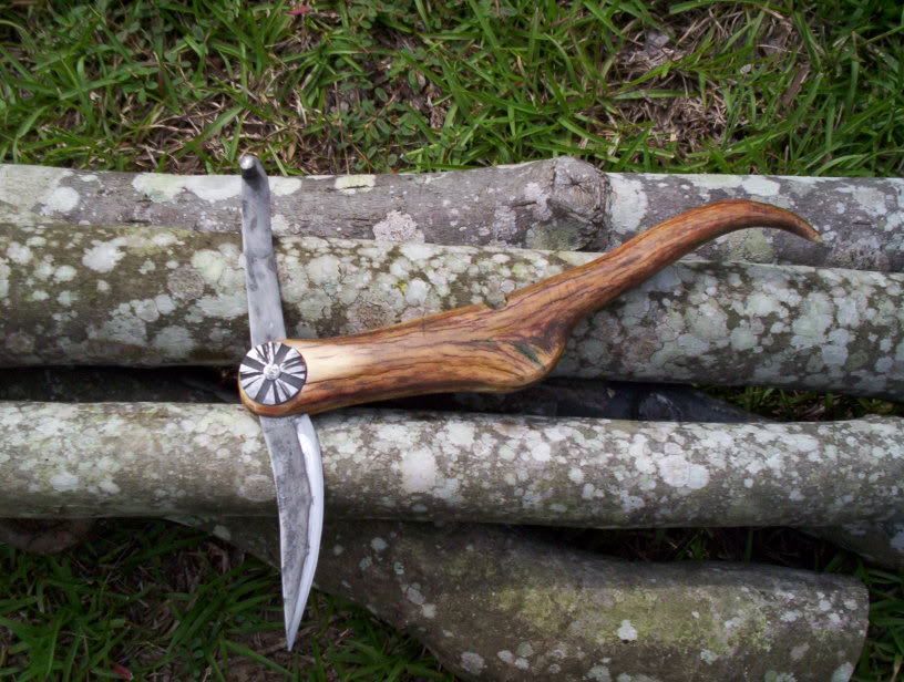

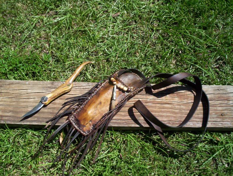

Here is an example of what you can do. This knife was made from a piece of antler that had about a 2"+ bend in the length of it. I needed it straight to allow for the blade of the friction folder to swing.
I don't have a picture of it looking straight down from the top but it is almost perfectly straight, this last pic shows the bottom edge and you can see the cut made for the blade itself!
About 20 minutes at a rolling boil and use gloves because you are going to have to handle it, and the quicker you get it from the hot water into a clamped position the better. That is why a vise works well with wooden blocks taped to it, besides it takes a fair amount of pressure to move a piece like this one with a 2" bend! :thumbup:
