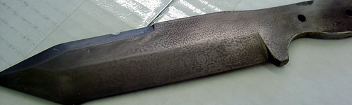

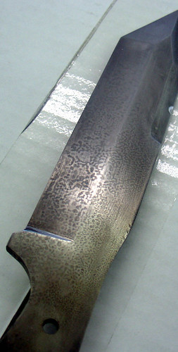

not sure what to make of this its the 2 nd cpm3v knife the first didn't look like this same heat treat but maybe i missed the temp or time just a little dont see how
so heres the specs
cpm3v
hand sand 220 grit
cleaned with vinegar
etch and steel wool scrubbing
i could sorta see the markings while sanding before any etch so im thinking over/under heated it
ooo and its realy just on the one side just a hint on the other
thanks for helping

I believe you have discovered CPM techno-wootz-like texture as exposed by the etch.
Actually I kind of like it.
only thing is it was from the same barstock as another knife and i didnt get the wooty etch
and btw i like it too i just want to make sure the knife is not messed up
shop user for me if it is :)
looking nice is all fine and good but if it was a bad quench or something i need to know so as to change my ways.
guess i need to talk to fitzo or mete
Butch, mete's a metallurgist, not me.
Nonetheless, in his absence I suggest we try to find out what we can. If the mottling is evident on the edge of the tang "spine", take it to the grinder and take off a little more than handsanding would do. Then re-etch. It'll tell whether it's a surface phenomenon.
If it's some kind of alloy segregation that's not a good thing. The whole idea of the CPM's is to get a very fine even dispersion of the alloy carbides.
Hope that's a start.....
How much of the rind did you grind off after HT.It looks like you may have taken the blade to too final of a finish before HT.Take off about .01-.02" and see what it looks like.It may not have that pattern any more.Too high a heat before quench is most likely the culprit.

Butch - Good,if the HT was OK,then it is probably limited to the surface.The data I was giving mostly applies to simple HC steels.High Alloy steels,like CPM3V have the additional problem of oxygen exclusion to deal with.Let us know if it goes away.BTW what temperature did you austentize it at?

the foil let go up in the false edge not much but now i know that it doesnt take much to cause a prob
going to make the decarb a grove to cut chainlink fence

got the sanding done and it was just at the surface of the steel lucky me
the austentize temp was 1950 for 27 min air quench
i think i should oil quench my smaller hunter and folder blades but for the OB knife i wanted to have it round 57/58 Rc had it tested and it was right there
acording to the data sheet im lossing up to 2 points Rc by air cooling
