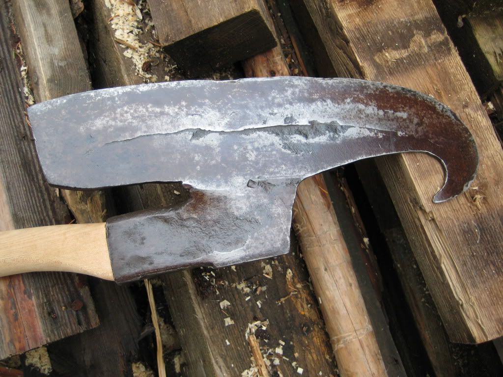

It was also a pretty strange tool, which I found with rust alover and a wormy handle. Well I used Christmas Eve morning restoring it at home. See what it has become :D
So far, I removed the rust and added a new handle on the tool. I don´t know for what it was used to.
The complete tool
The tool in size comparison to a Mora 711
Here is the front side
And the back side
Here you can see the smitty´s mark, I don´t know who could have made it. What dou you think, is it hammer- or handforged?
The tool could be about 150 years old. My great-great-granddad was a carpenter. Maybe it was one his tools.
Nevertheless, I´ll keep this beauty in a save place. I love it, it weights about 4 kilogramm.

Maybe a sugar cane knife? But the shape is a little odd.

I agree with Pipeman - looks like an old timber framer with goosewing pattern and extra rounded tip - nice looking no doubt. I wounder how functional it was - i would think someone would get tired pretty quick swing that thing, especially bent over.
Great looking piece though, and has the family history to it also, so you will be able to continue to hand that down, which is perhaps more important than the piece itself.

I also thought, that it could have been a tool scoring timbers. Here in Germany it could be called a "Behaubeil".
This must have been a really hellish-heavy-job. That axe is really heavy, working with this monster the whole day would cause a bear-of-a-man to work with it the whole day. I don´t know its weight, but 4 kilogramm or more can be possible.

I agree about the fatigue aspect of using one of these with such a short helve. I'm not sure how they were used exactly but maybe they were used horizontaly with the timber on horses. All the guys I know who still use broad axes for timber framing and log building have long helves on their axes and stand on the log to square it. I can't imagine swinging a 9 pound head on such a short handle and all of the goose wings seem to have them. Maybe it was used almost like a chisel or plane with one hand on the back of the blade. Maybe someone who knows could chime in.

Ok, there are you right, for sure. The short handle is an exact rebuild of what was on the axe before. I made the same on it, same length, same shape and so on.

I've seen similar ones (though without the top hook) being called a "doloire" at online auctions. Looks like an axe for hewing, as others have noted.
I didn't find another example, but did find some interesting sites, such as this page about the making of wine barrels:
http://www.anciens-outils.com/tonnelier.htm
Which led me to this page showing hatchets used by makers of wooden shoes:
http://www.anciens-outils.com/page_haches-sabotiers.htm
And other cutting tools used by wine makers (some with curved tips):
http://www.anciens-outils.com/page_hachesdechais2.htm
It should be noted that such an axe would not have been swung like you were chopping a tree.
This is an axe for rough shaping of timbers - so it would have been used in a more controlled manner, by a man atop the log or in a pit beneath it.

Well, "Breitbeil" means translated "Broad-hatchet". A carving-hatchet seems the most logical to me, as well as it is already said.

Yeah, it's obviously a broadaxe.
It's used to square logs.
The "goose wind" style with handle socket is quite typically german, at least South/South West Germany/Switzerland.
"Doloire" is a French name for broad axe (maybe regional name).
I've never seen one in person but they spring pretty often on ebay Germany. If you're interested in value (or for information) I'd say they go for 30€-100€ depending on condition, although prices seem quite random.
The curled tip is unusual, but I think I've see others.
At 26 seconds into this video there is a very similar axe being used. I've seen axes of this pattern referred to as "Breitbeil". As a German speaker maybe you can confirm if that name makes any sense.

looks like that is in fact a hewing axe. German style.:thumbup:

nice tool, looks forge welded, i would not mind using it on a project.
you did a good job cleaning it up, if you plan to use it.
