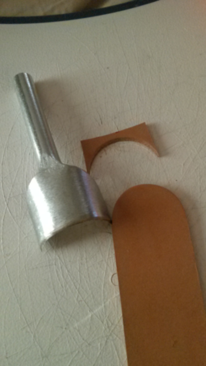

Well, I said I'd give my thoughts on the punch when it arrived. It arrived.
Observations.
The handle is much shorter than I thought it would be, but having never seen another in person, it may be the same with many of them. Anyway, the length of the handle is fine with my mallet and even my huge hands don't get in the way.
The width is correct. I don't care for the arc in terms of what I usually make a round cut for, but it's ideal for belts and is well represented in the pics.
I can't really imagine what type of steel this is, but it certainly doesn't look high end. The bevel is somewhat sharp.
In use it's pretty bleh... I literally had to hit it a dozen times on a poly board to get through 7/8oz. Not something I'd want to do very often.
Let's be real though, the thing was like 5-6 bucks, and (when it finally does cut) it cuts a very nice and clean line.
One thing I forgot to do was look at the bevel against something flat to see if the edge is straight. I imagine I can get this in much better shape with all of the sharpening equipment I have. Don't know how often it'd need touched up, but I'd guess fairly frequently.
If the arc (or I think they also sell a "v") looks good to you and you don't plan on using it super often, you might give one a try. Again, you can't beat the price. On the other hand, I usually recommend buying the best you can afford from the get go.
