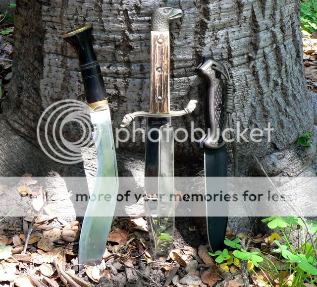

I just have a quick question for kukri owners here. I know the chopping efficency of a kuk is on par with a axe, even better in somecases. So I've been thinking that it would b neat to buy one from HI, 15"-18".
But after looking around, I noticed kukris have a very thin tang, tiny in fact, are all models like this? and how long will the handle of one last compared to an axe poll.

Some khuks come with a full-length/full-width tang. Doubtless, such a design is stronger. However, recall that the more traditional design, which you have illustrated, has been used for hundreds of years. Many (including me) feel there is less impact to the hand and wrist with the traditional design.
My only negative experience was with a very old, village-made khuk. The handle became loose, and I had to heat the handle to reset the laha (glue). It was no big deal.

and do a search on tangs. We liken the HI hidden tang to a Kangaroo Tail instead of a Rat Tail tang and they are plenty strong enough.
The only way one is apt to break is if the kami slipped up and got some water on the tang when he was hardening the edge. And even if it should break the HI Guarantee covers it completely as long as you are the original purchaser of the khukuri, and as has been mentioned HI makes some with a Chiruwa handle that is a full tang if you prefer that sort of thing.
I have several, several, HI Khukuris and have yet to break a tang and all except for maybe three of mine are the standard hidden tang that I much prefer.

ok, let me clear this a little more, I think im confusing some. I dont so much mean the blade it self breaking(though that could happen), but the wood incaseing the tang.
As in the handle breaking, like the handle breaking away from the tang.

As to the handle, there are two reasons IMO to go with a hidden tang knife. Firstly, the tang is not thin. Its usually between 1/4 and 1/2" thick, and wide also. They go all the way through the handle usually and are peened over a brass keeper. Lots of strength inherant in that design. Its by far my favorite type of handle.
Secondly, maintaining a hidden tang khuk is an order of magnitude easier than an exposed tang model. The scales on khuks tend to shrink, exposing sharp edges on steel that have to be filed away. That is a LOT of work. This isn't a problem with the hidden tang models. For this reason alone, I suggest avoiding exposed tang models.

You don't want a full tang, in a chopping tool, full tang increases a lot felt vibrations. I have a 10 inch bladed chopper without any scales. Handle is forged in way that it fits hand quite well but vibrations are terrible.
Hidden tang will be a lot more comfortable and it is not that weaker.
