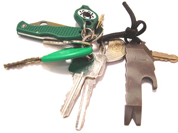

My Atwood Prybaby has a couple of little lugs built in that fit the SnG pivot screw.
