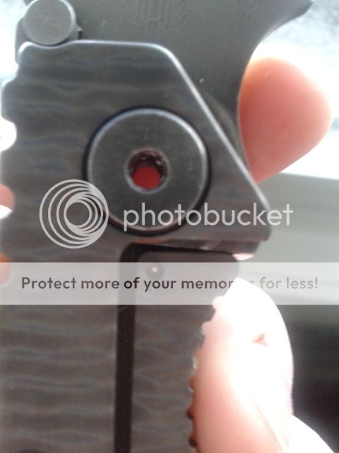

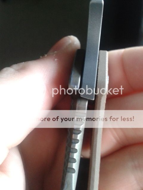

I this typical lock bar to tang contact only about 10%
Yeah it`s part of the durability of the lock bar. With (hard) use the lockbar with travel further in and engage more. I can show you a pic of mine in a couple of minutes.
That's a proper liner lock. The lock face shouldn't make 100% contact, irregardless of the total amount of travel.
Shes GTG, I believe thats part of the design, and the whole lockbar cannot make contact with the blade tang, that is where your problems come in.
You want the lockbar and lock-tang contacting at a small point as far away from the pivot as possible for maximum leverage/strength.
Your lock is properly designed.
Bob Terzuola's book, "The Tactical Folding Knife: A Study of The Anatomy and Construction of a Liner-Locked Folder", is a great read if you want to know more.
You might also check out http://emersonknives.com/blog/emerson-knife-anatomy/, about half way down it explains exactly what you are questioning.

Having lock rock does not mean the lock will fail.
To be sure, go wedge the blade and put considerable pressure on it and see if it fails.
Even though many of the old (radiused) lock-up Striders get lock-rock, many (including me) consider that lock-up to be stronger than the new lock-up.
Just go test it to be sure.
Heck, it's fine, you have plenty of lockbar onto the tang. Looks like you have about 60%. That's quite a bit. I have plenty of folders that are 10-15%, but will wear in and travel to the right with time and use. No problem at all.
