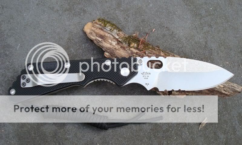

From an ergonomic point of view they are similar. The quality of the blade ( BOS ATS 34 version ) is very capable. The thickness of the liner is a bit "lacking" but also capable, I carry mine all the time. Would I buy another Buck if I lost mine? Yes if I could find one.
Heres a pic of my Buck

Its so if you miss the thumb hole, you'll still get the blade open. I like the Bucks, but they really dropped the ball in the liner thickness IMHO. The thinnest liner I've ever had, would fail a light spine whack everytime. Great otherwise though! SnG is cool, but way overpriced for a semi midtech.

The upper swedge is stippled so you can grab it with a finger on each side and deploy the blade. As you can see in the pictures there is quite a bit of blade real estate that sticks up over the scales.
I have the original Buck Tarani Strider collaboration and an SnG - and there is quite a bit of difference in the knives. Shape and ergos are very close.
Buck: G10 scales, stainless liners, stainless liner lock (thin), blade steel varies (ATS 34 seems to be the common steel), stop pin is not press fit, blade was not ans is still not centered, heavy knife (heavier than the SnG)
Strider: G10 and titanium, frame lock (thick), heavy duty bull pivot, S30V blade steel, titanium pocket clip, stop pin press fit, SOLID lock up, better fit and finish
The Buck is a capable knife if you use it with some degree of normalcy. The Strider begs to be abused. I am scared to do some of the things to my Buck that I do to my Strider.
