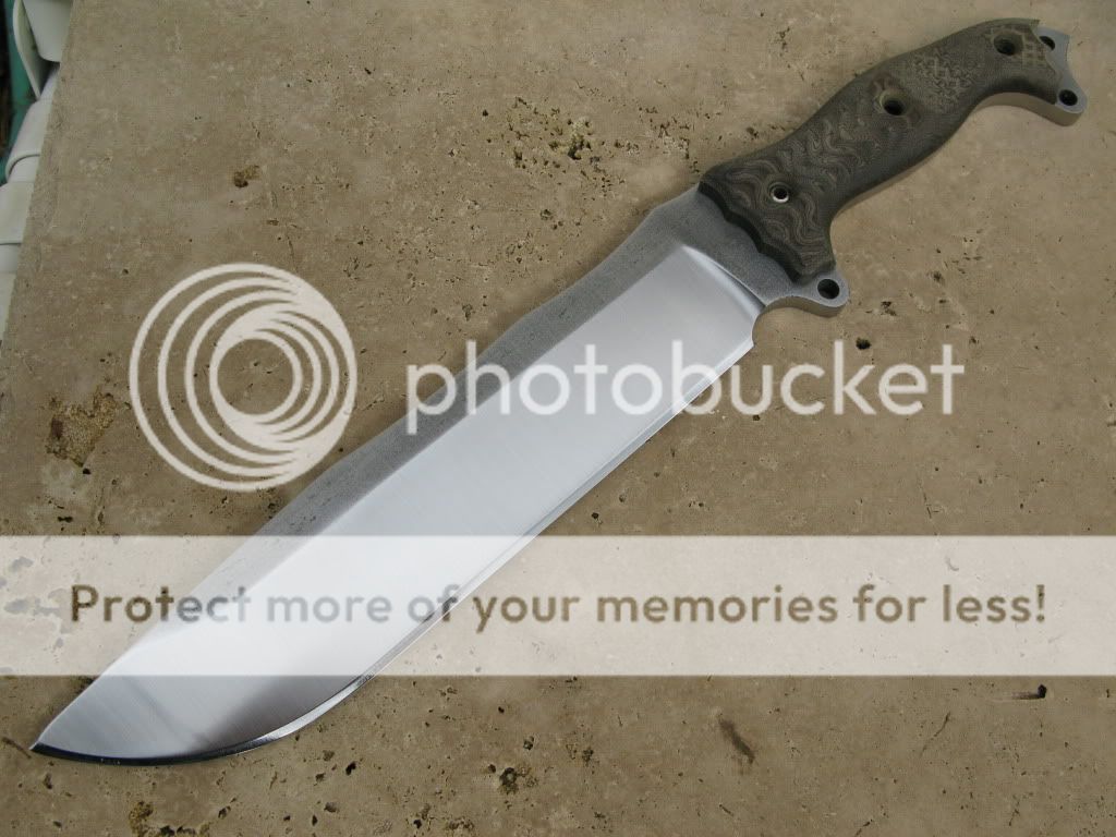

Heres my FFBM stripped half satin and then the last 2 are pics of it fully convexed. It takes some patience and belt sander to make it convexed.
Norcalblacktail, nice work :thumbup:
I want to use my FFBM a lot more before I strip it and do a lot of sanding, I hope it turns out half as nice as yours did. I'll be doing it b hand so it'll take some time, patience, and a lot of sand paper.
