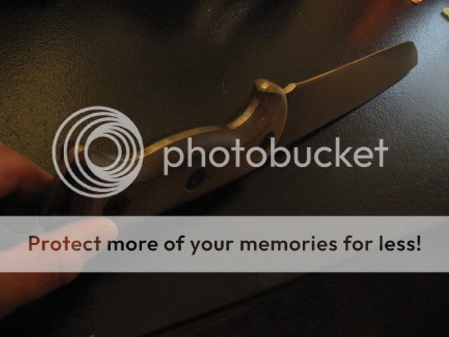

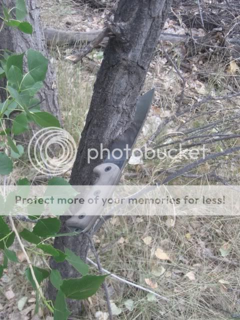

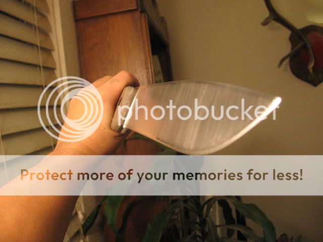

Well I seemed to have lost my good original pics from when I did this to mine, so here are some from just now and a few old ones that are "ok". Blades a little scuffed and stained as of now, but you get the idea lol. It was very very purty when I first did it though. Left the "choil" and the flat part of the handle rough and with the HT color. I didn't want the grind lines completely out hence you seeing them still.
Process: Stripped with Jasco Epoxy Stripper from Home Depot. Slow speed on the orbital sander with slightly worn 350 grit and a squirt of Mothers Wheel Cleaner. Then finished it up by hand with some scotch brite and a final buff with some Nano Wax lol. Took me a few hours if I remember correctly. The convexed edge turned back into a V haha. Haven't used it in a while now.
