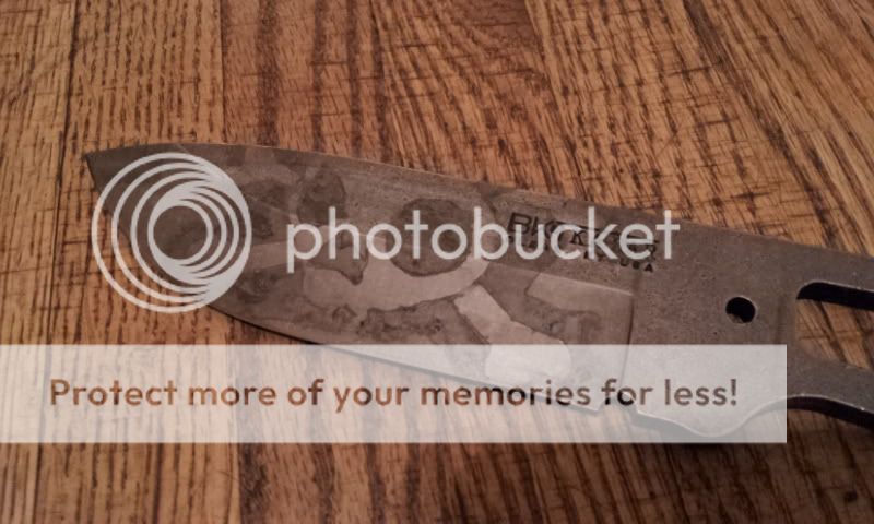

I prefer stripping the whole blade..I think it looks better. Be sure to lightly oil it after the strip. As for a patina, I did a fast "light" patina with wine vinegar then applied a decal that I made, and went over that with some brown mustard using a cotton ball. I'm gonna try my hand at etching soon. I agree with Uncle Malice..if you have about 3 spare hours do the strip and take it camping with ya' :thumbup:
