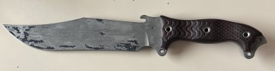

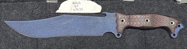

I had a Midnight Blue Fusion Silent Night with red/black machined G-10 handles I was considering stripping, since I had put it up for sale… and it didn’t sell.
I had a can of BIX stripper that had recently started leaking & set it outside a couple months ago.
I figured I might as well go for a strip.
Etched first…
I mixed hot water / salt in a shot glass. Dug a 9v battery out of my stud finder, and grabbed three Q-tips & some alligator ended test connectors from the garage. I used each end of the three Q-tips about 30-45 sec. Etch complete in about 4-5 mins.
15-20 mins after stripper applied, used plastic scraper. Here’s first pass:
Second pass, and used brass wire brush:

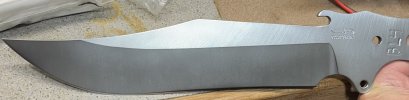

Getting the tubes out was a little work. After drilling & trying to punch the tubes out, one scale only lifted about 1/16”. I ended up using a wood chisel to drive in & pop scales off.
I had done most of the drilling from one side, and drilled about half way through. This left the tube wall thickness intact on the other side. I popped the scale off of the “weak” side. I was happy to have one tube side meatier, so I had something with some integrity to pull on with vise grips. Eventually they came out. Then I had to strip coating under the scales.
With the coating softened up, I used a screw to poke/rub out the coating from talon/lanyard holes.
Ready for next steps…
Randucci said he had used a 4” Scotch wheel on some finishing efforts, so I went looking…
And bought some 1/4 x 0.028” 304 seamless tubing.
I ran through the different grits, but I think I’ll go a little more…
