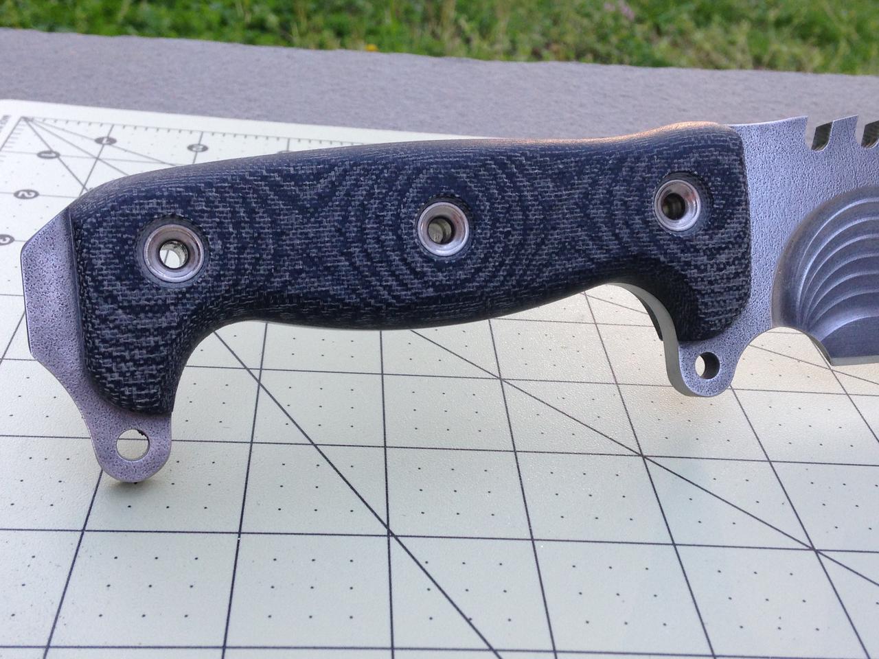

This one still has the coating left under the scales. I would venture to say that what is left is so unnoticeable that if you didn't tell someone about it, they would never notice it was there.

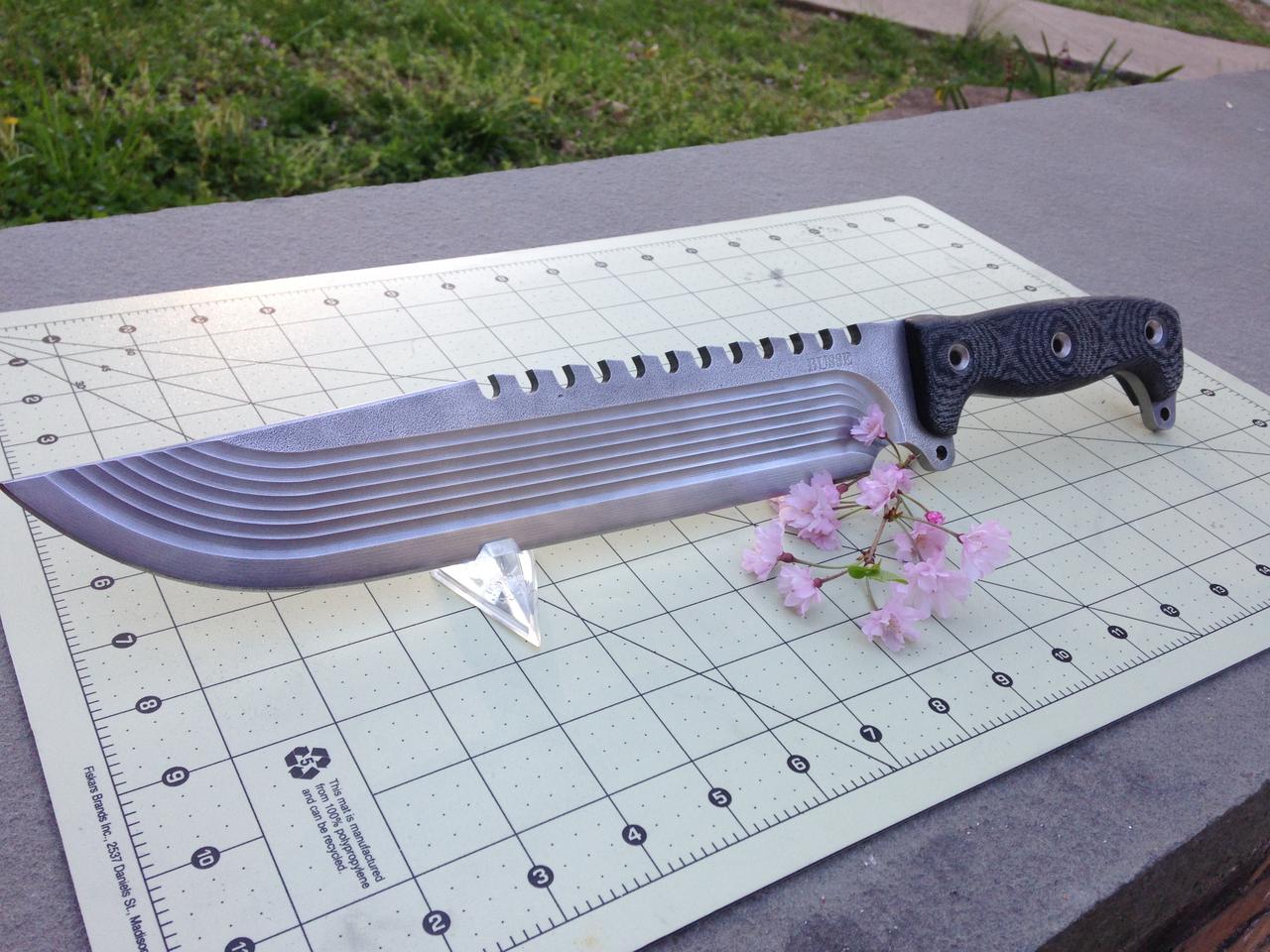

Coating stripped shows the decarb,
About half finished sanding,
Finally down to steel.
It also seems different from model to model. A SHe I had was fairly quick work, where as the NMFBM shown in these pics took many hours of hand sanding.

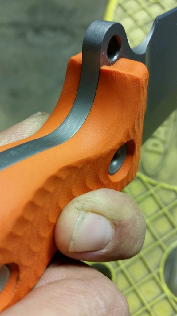

Just a heads up, this is what I found under the slabs on my HUCK. I'm glad I pulled them now... this spot where they stripped the coating was rusting pretty bad from the decarb.
