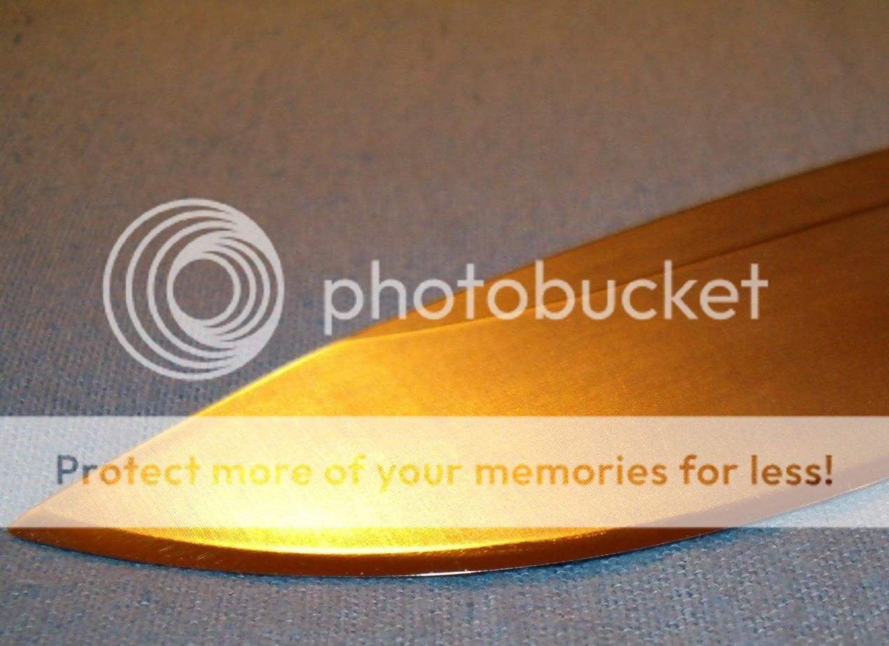

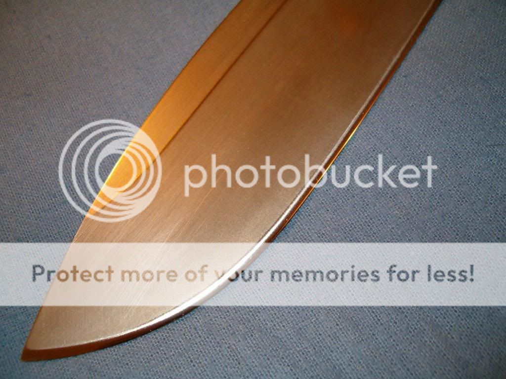

stripped and smooth
silverdragon33
Apr 30, 2007
1,530
nice and smooth underneath. should be cutting way better than with the abrasive coating. this is a user so i kept the coating on the rest of it. i may try and even out the edge of the coating sometime, as well as put more than 10 minutes of work into sanding the blade to make it look nicer. that 10 minutes got me nowhere except for a few spots. it looks a lot worse than in the pics (couldn't capture the darker spots), but it's a fine user. and it looks way better than the razor i stripped a few days ago.
i was surprised, the tan coating took forever to come off after applying the stripper. and when it did come off it was only in spots (not necessarily where the most stripper was applied either). took two coats.
saber grinds just look hot naked. i guess the shape and curves of the knife have something to do with it too.
this thing is sharp. couldn't tell very well with the coating, but the edge is ground pretty thin for a Busse. in fact, the edge is about the perfect thickness for an all around knife.
very nice. I need to get to stripping my SS, now that the finish is getting a bit more beat up. I need to beat on my Ash1 before I strip that one.
