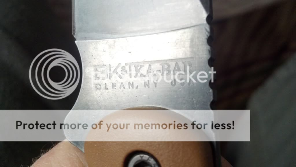

I decided to strip a couple of blades, one was my BK-15.
I picked up some etchant from Radio shack and stripper from Home Depot and used green 3M pad to smooth it out, cold blued it then convexed the edge on my home made strops.
I started the etching Yesterday after work, I just puddled it on the logo, let it sit for an hour or more, clean it off under hot water and a bronze brush it and start over, probably took 3-4 applications on each side.
Then it's into the stripper, it took two applications and a bit of scraping.
After stripping I buffed it with green 3M pads and gave it two coats of cold blue, then gave a hair popping convexed edge.

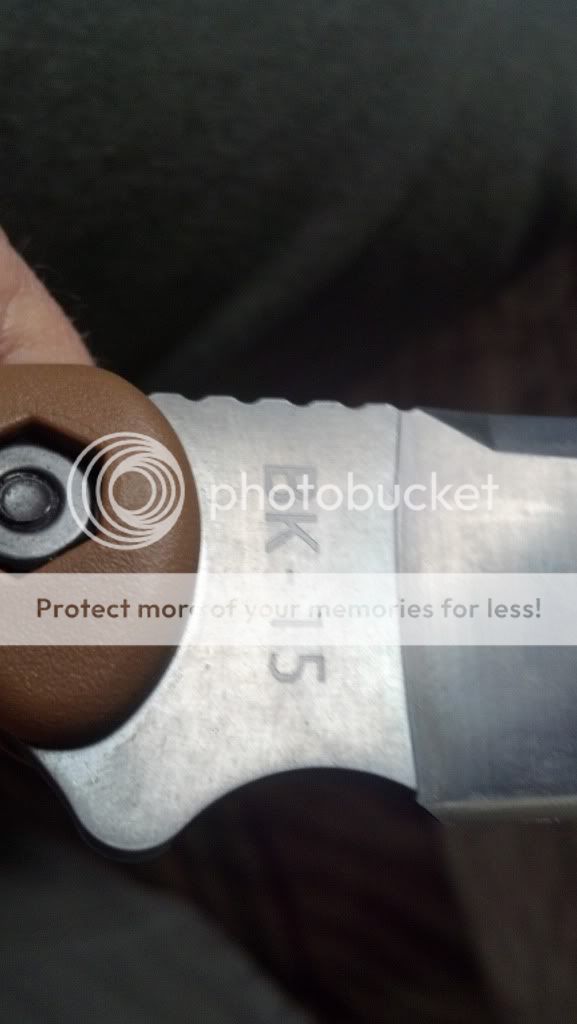

Alnamvet68, I'll take pictures this after noon on the logo's they are all there just hard to see being all blued.

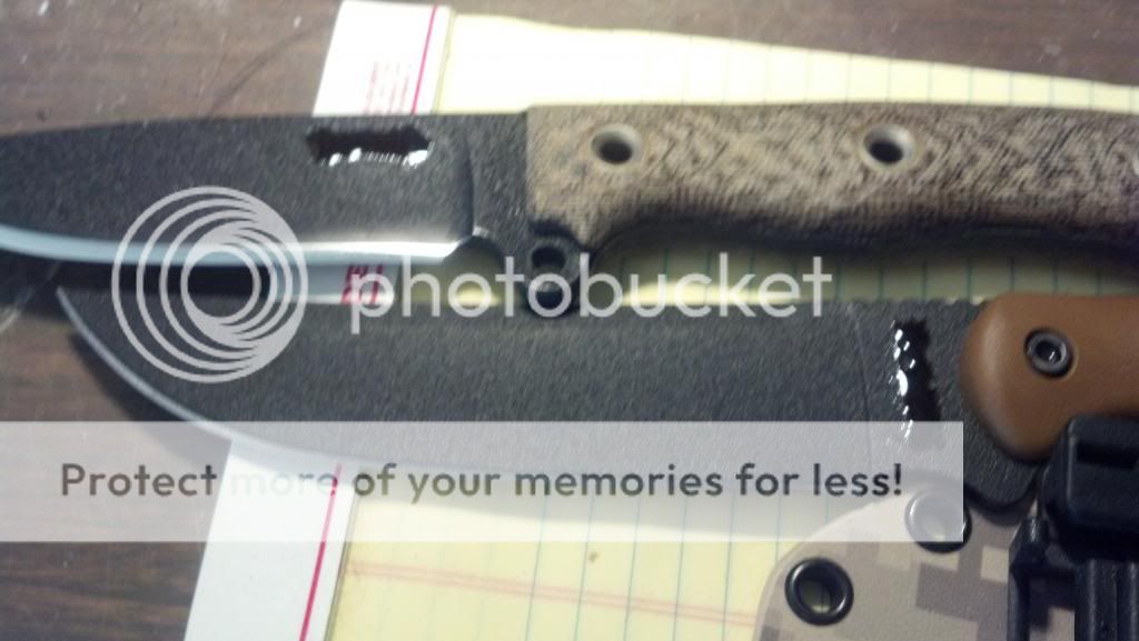

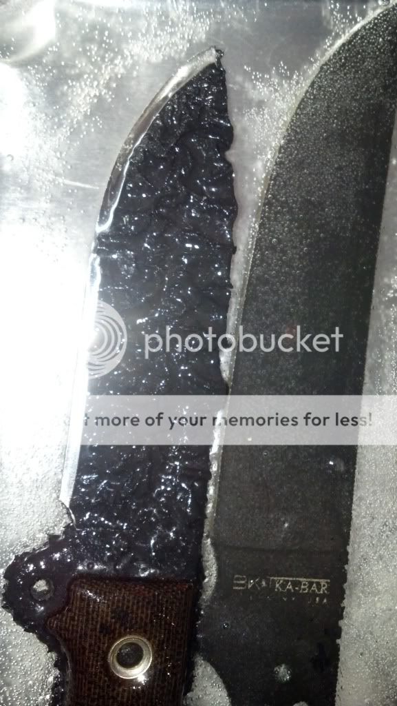

Ray Settanta, the black canvas micarta on the Busse is not affected by the stripper at all, just dries it totally out, I put some olive oil on the Micarta and it looks like new. After stripping I cleaned the steel up with the 3M pads and called it finished.
Here is a pick of the Boss Street afterwards.
Damn that Boss blade is beautifully done.

Cool. IS the logo not etched very deep from the factory? I supose it is just a light laser etching? How deep is it now after using the PCB Etchant?
Thanks,
Greebe
The etching did not look very deep from the factory, but may have been fine?
I'm not sure how deep they are now, I didn't go crazy with the etchant, just wanted to be sure the logo's would still be there once stripped.
