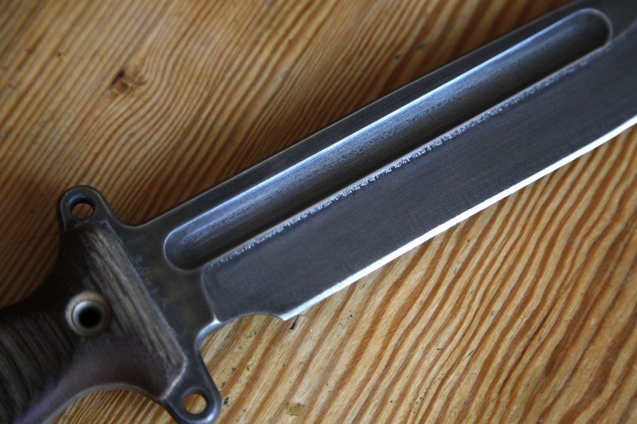

Yes, finally stripped one of my TGLBs.
Did any of you guys ever have that much decarb under the coating?
Already removed a bit of it - really time consuming without power tools.
I really like the look of it now but the decarb rusts so fast.
I could imagine that the decarb rust is easier to remove than the decarb so I could force it to rust.
What do you guys think?
Not 100% sure yet if I put some custom scales on it.

You definitely need to remove the decarb. Scotch brite wheels, or good old fashioned hand sanding works great
good move...
decarb is a pain to remove...
my advice would be to break down and shell out 50 or 60 dollars and go buy a decent bench grinder or Dremel tool with some various grits of scotchbrite pads and get it over with in a few minutes...just stay clear of your edge.
or you could keep at it with coarse to fine sandpaper-- I've done it both ways.
and it does rust incredibly fast-- you can actually watch it rust before your eyes when you wet it!

I don't know if you saw the thread, but I stripped and decarbed my BG AMS recently. I could have used my belt sander, but opted to tackle it by hand.
I thought it went fairly quick with 320 grit wet/dry sandpaper and very fine (#00) steel wool (used mineral oil as a lubricant, dust suppressor with both). I'm sure it would have been quicker with coarser grits, but I was wary about putting a bunch of deeper scratches in the finish that I would potentially have to spend a bunch more time moving up through various grits to remove. Of course, the AMS is a much smaller blade than a TGLB, but I'd say still very doable.
Interesting idea on letting it form surface rust and then removing it. Don't know the answer, maybe?

The cheap alternative (IOW, the way I do it) is to get a ScotchBrite wheel that chucks into your drill. Then you put the drill in a vise and use it like a bench grinder (my way) or put the knife in the vise and run the wheel over it. Either way, be safe. I wear cut resistant gloves in that operation.
