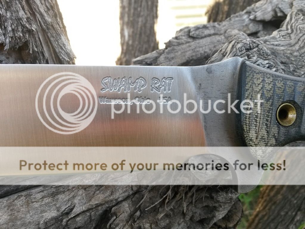

Here's a few pics of the girls now that they're stripped. The 3/16 Ratweiler is the one I got off of Chirol. Thank you kindly brother. The Kydex sheath is doing quite well also brother! She came out REAL nice with a ghetto finish which is just the way I like them. I don't like to carry one with a mirror or reflective finish. Now the RMD ghetto finish is a horse or rat of a different color. First of all, I don't have a smart phone and my camera is prehistoric. If you look close if front of the logo, there are some tooling marks. I'm not exactly sure what was going on in this process. I'll try to get a better pic. It looks like somebodies tool got away from them. She didn't strip as well as the Ratweiler did. The blotchiness is prolly my fault with the stripper.
My question to all you dirty Rats is, how can I make the RMD look more like her mother? How can I get rid of those ugly birthmarks and still have a ghetto finish? I see why they covered this one up with an opaque finish.

Hate to say it, but I think that is going to take some major elbow grease and sandpaper to get those chatter-marks out of the RMD. Dang, I wonder what was going on there?! And WTH were they doing with the tool to end up putting those there?!
I'd just bite the bullet and get to work. It should only take you about 3 hours working up through the grits to get the marks out. Then I'd suggest a mix of PCB etchant and water to put a gray finish on the blade.

I put a brushed finish on a Rat Daddy using a medium Scotch brite belt - didn't take away from the character of the steel nor remove much!

Thanks Dicko and RockSpyder. I've stripped a few also and I've never seen anything like this either. What a surprise in the wrong way. Like I said, I dearly loved the turn-out on the Ratweiler. This almost looks like something I'd do if a hand-held engraver got away from me. Sorry for the irritating pics. My ancient Modern Marvel camera works for most things except close-up. This boo-boo looks hideous in person.

This from Radioshack is the etchant I'm talking about. Full strength, it will etch the engraving deeper, instead of having to use the electrode method. But, the best way to do that is to dip it. If you do that, though, you have to protect the edge and any exposed steel you don't want eaten with something like fingernail polish or something. Paint will work, too, but is harder to remove. A little acetone will take the polish off, but the etchant doesn't. And it doesn't eat the factory paint on your Rat. I've not done it with a SRKW, but I have done it with TOPS and BK&T coated blades and it worked fine. Especially with the TOPS. The BK&T blades are more rust resistant after stripping, and it seems to show in how long it takes to etch the logos deeper.
Anyway, the other way it is used is to mix it with water to dilute it. I want to say 1:4 mix, etchant to water. If you want to ask an expert, one I know that is on here is RWN2000. He does it to some of his blades as a surface treatment for corrosion resistance. I've got a couple that he did that way, and it seems to work well. I'm gonna strip some Rats once the weather gets warm enough here in MD to get the stripper to work well, and I am planning on using the diluted etchant on them.
