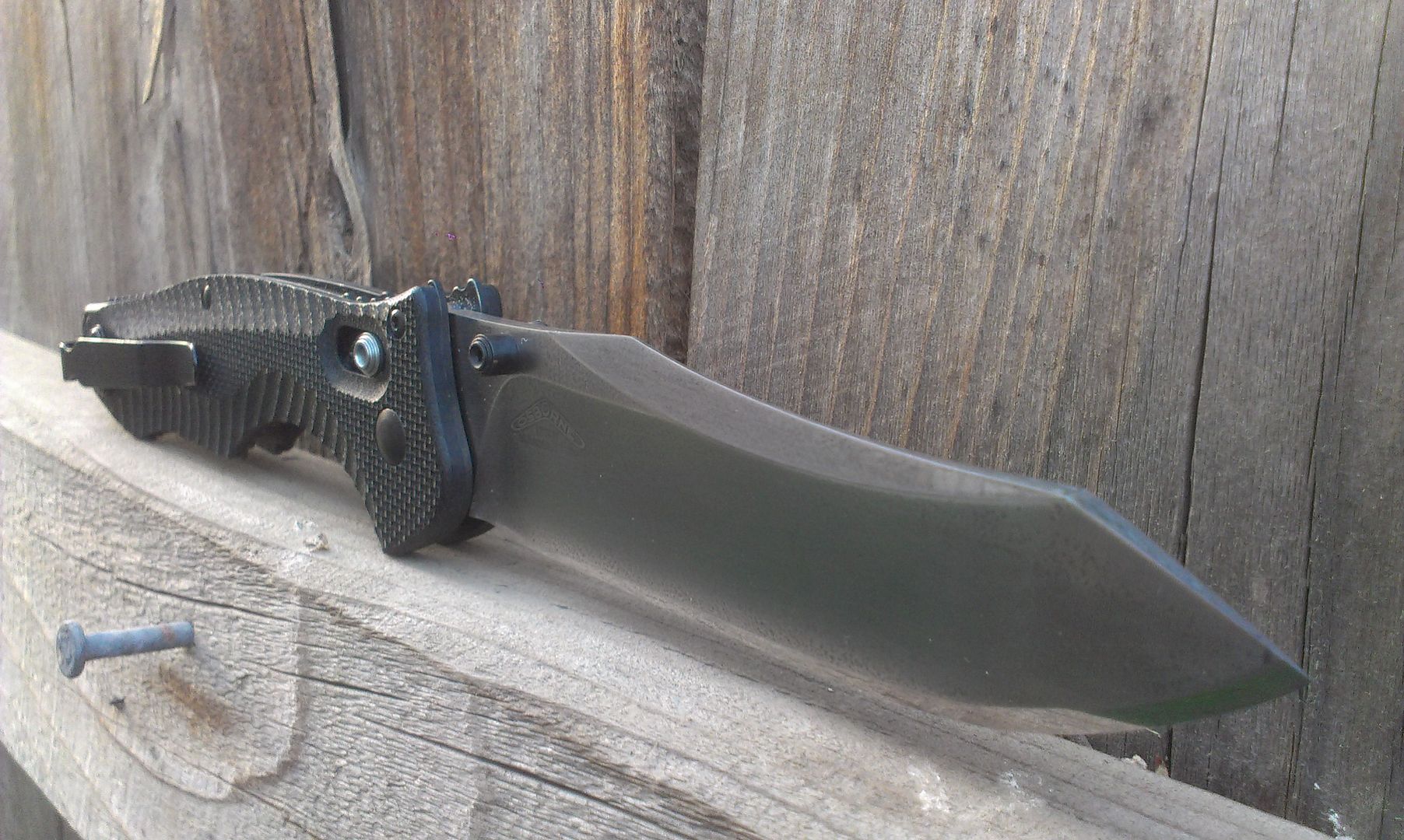

Here's the blade after a little bit of scraping with the s&w.

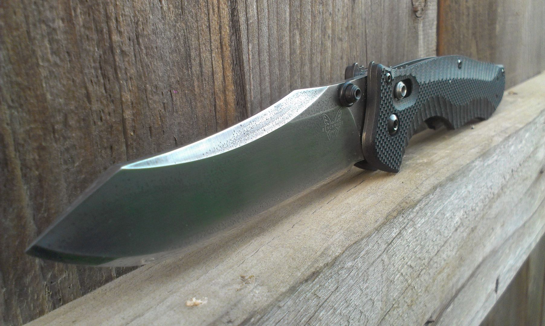

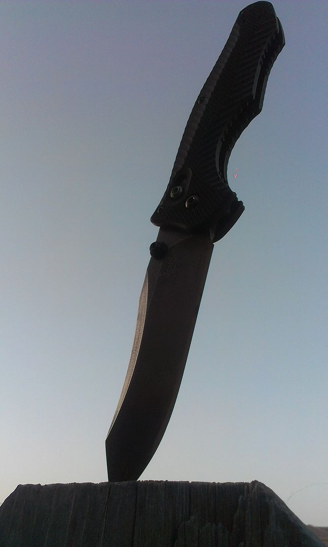

And a few shots of it as it is now.
Obviously I've sharpened it. It's got a near mirror 28° edge with a 30° microbevel. I more than expected the edge out of the jar to be extremely dull and corroded, it was still pretty sharp, and I may have gotten away with a serviceable edge by stropping alone, but I wanted to reprofile it anyway.
The steel has some pitting, but I actually like it. I'm very very pleased with the stripping and would do it again in a heartbeat.
The knife is very sharp, it has retained the logos, but best of all, that awful (to me) coating is long gone.
