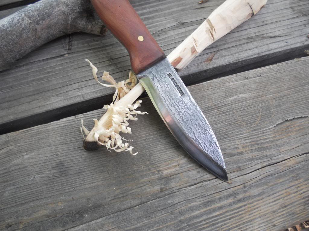

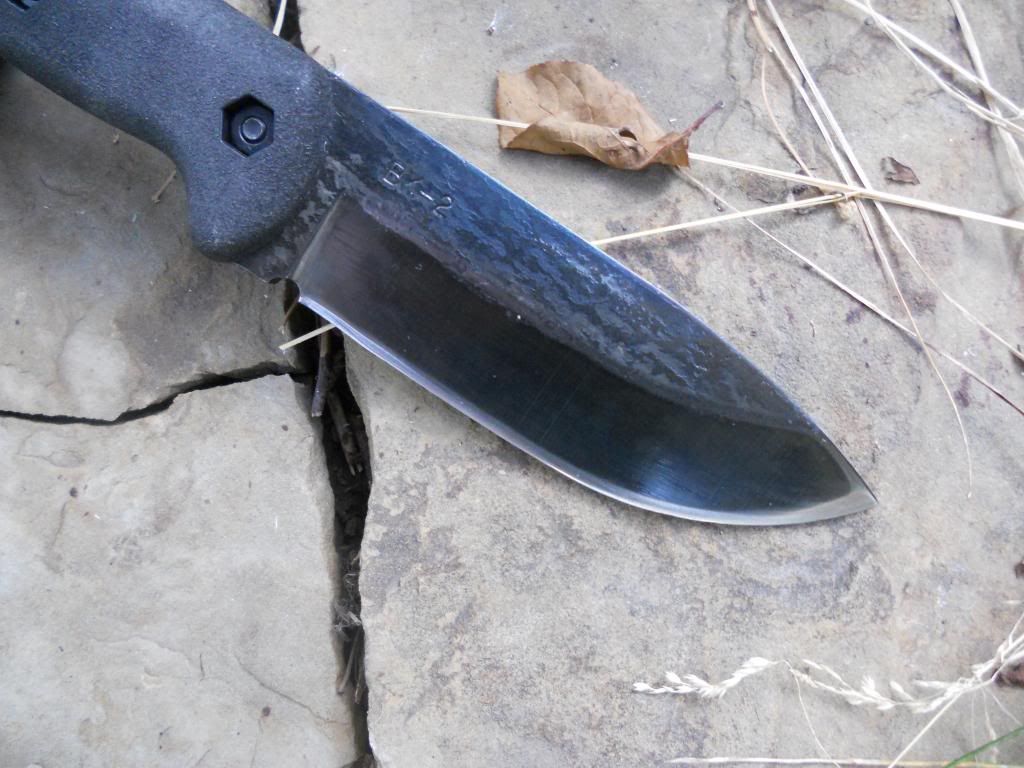

Here is a picture of FPS BK16 owned by wasatch dan that I think looks pretty good. Its been stripped, etched and blued.
Thanks B! That's the exact info and pic I was looking for. Not too worried about the FPR as long as the sig stays and that one looks great!
Even though it's pretty much answered...don't let that deter y'all from contributing...esp more pics!
I used ferric chloride for the initial etch to darken the metal. The petroleum jelly resist I used on the edge is what gave the FPR 16 that hamon-like line near the secondary bevel. After that I used the blue/bleach etch along the flats of the blade to eat away some of that godawful FPR engraving. This was only my third try at Cliching a knife (that's what Beckerheads called the strip/blue/bleach etch/convex mod a few years back), and I would do things today that I didn't do back then, especially making sure the temperature was up over 75 degrees. I did this in around 40 degree weather, and neither the ferric chloride nor the bleach ate away quite as much metal as I would have liked because of the cold. Warm temperatures work better. The Saber-16 still turned out pretty good, but I've done better since.

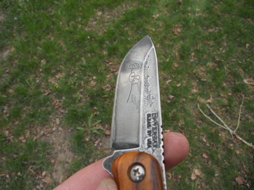

What is the knife featured in the second pic down?
Survivormind
Thanks, fellas.
The second knife down is the Blackhawk Tatang. Very good knife and surprisingly affordable. Comes double edged from the factory. It's primarily a fighting knife but could work as a decent bush knife in a pinch.

Wasatchdan,
What did you do to get the pattern on the Blackhawk Tatang? I'm guessing the results are not food safe?
