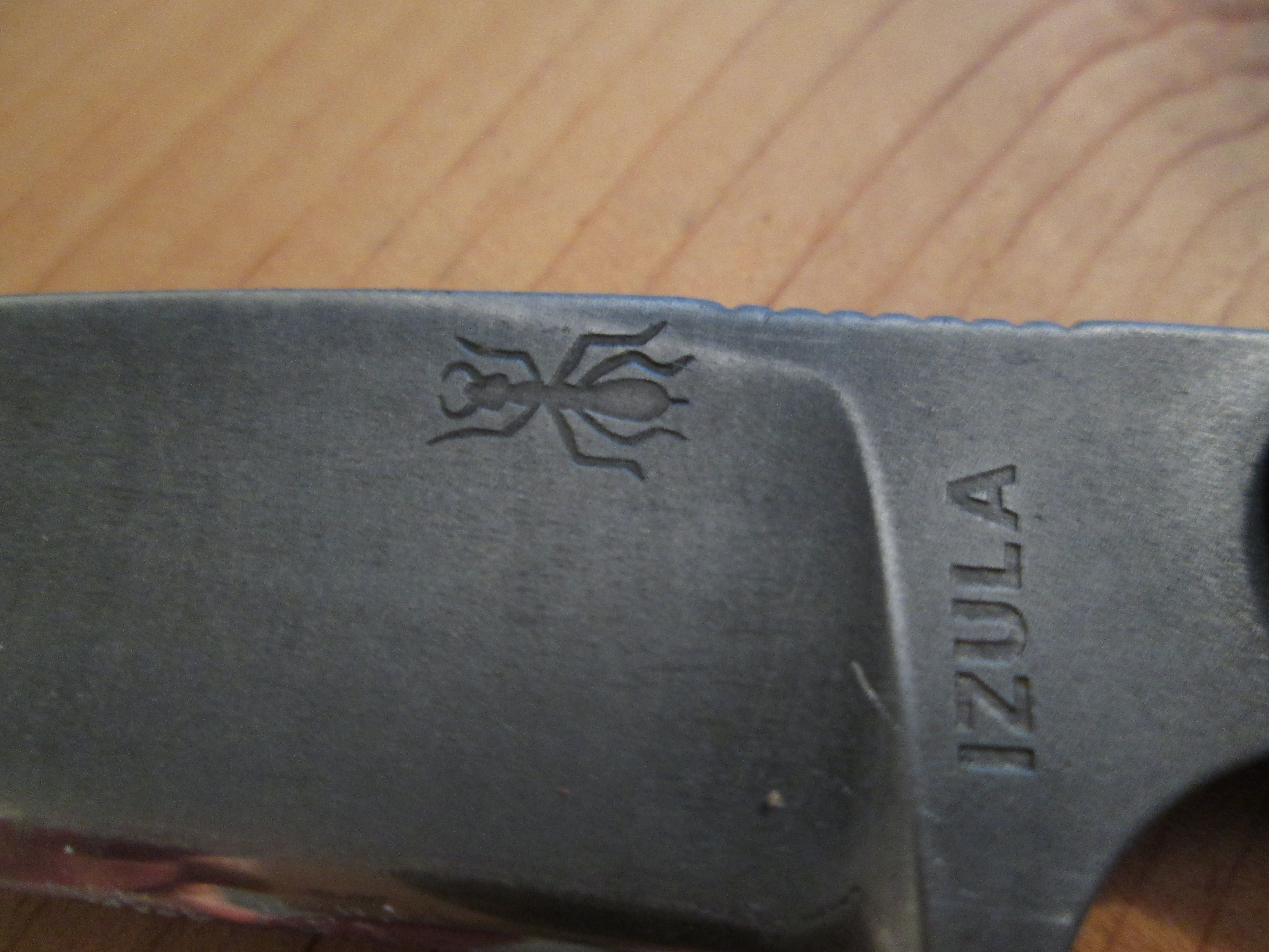

Here's a pic of my stripped Izula. I first used the Radio Shack etchant on the logos and tangstamps. I had trouble with it running underneath both electrical and painter's tape and damaging the edge. Because the logo is on a slant compared to the tang, you can't keep both level so you need a way to keep the etchant in place. Finally I made a little "moat" with hot glue and that worked well. Next time I'd do them in separate passes. Took all day because it was spring and hadn't warmed up yet. I then used some some kind of orange paint stripper (don't remember the brand) and finally gave it a vinegar patina.
