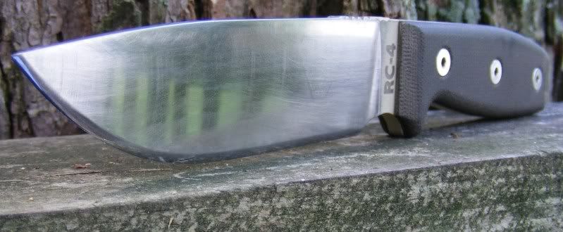

Here's a tan RC4 that i stripped with BIX gel stripper.
I was concerned about the handle area also,so that part was left alone:
Still had a little more polishing to do at this point.
I just brushed the gel stripper on where I wanted it & didn't have any problem with it running anywhere else.
Took it off with a razor blade & then started polishing with wet/dry paper.
